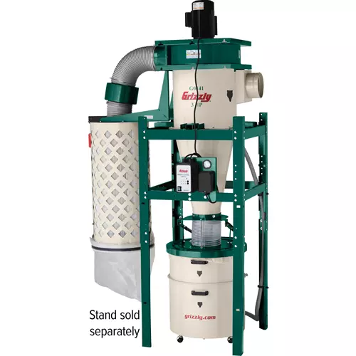

G0441 3 HP Cyclone Dust Collector
A dust collector ready to hook up to three woodworking machines at once.
The cyclonic action of the G0441 3 HP Cyclone Dust Collector separates the heavy dust particles from the fine particles and drops them into the 55-gallon steel drum.
The fine dust travels past the 15-1/2" diameter steel impeller and is then trapped by a cartridge filter made of spun-bond polyester that filters 99.9% of particles from 0.2 to 2 microns in size.
The BIA-certified cartridge filter is pleated to provide 113 square feet of surface area for efficient air movement. A clear plastic bag collects the fine cake that shakes off the filter for consistent dust collector performance.
Casters mounted to the drum also make disposal of the larger chips and dust as easy as it gets.
Other features include: a vertical motor support for reduced vibration, thick walled 11-gauge steel blower housing, 14-gauge steel cyclone body, 360° blower rotation for easy connection to a duct system, TEFC Class "F" motor, and a magnetic switch with remote control device.
Stand Sold Separately
While wall-mounting brackets are included with the machine, the optional steel legs and support frame of the H7509Z would make setup of the G0441 easier and also the increase the stability of the unit.

Shown with H7509Z optional stand
