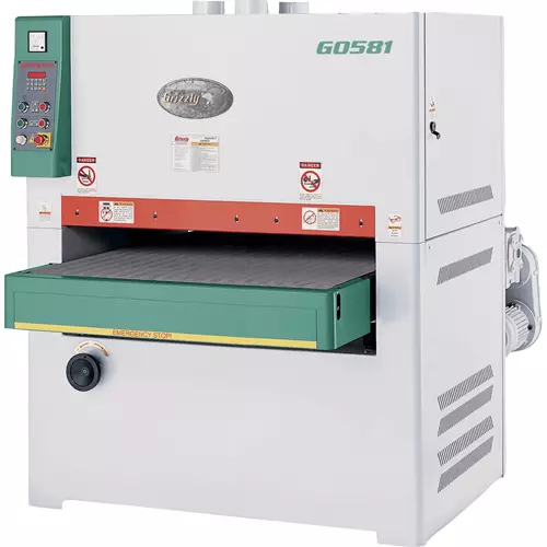

G0581 43" 25 HP 3-Phase Double-Drum Wide-Belt Sander
The dual heads of this wide-belt sander speed up your production times.
Rarely can a machine claim to cut your sanding time in half, but the G0581 43" 25 HP 3-Phase Double Drum Wide-Belt Sanders features dual heads allowing to sand two different grits in a single pass!
The first belt runs on a single drum and the rear belt runs on a platen system which allows you to adjust the sanding depth. The sanding belts are 43" wide by 60" long. A full range of replacement belts are available.
If you are still sanding through two grit levels using a single head wide-belt sander you are not being the most efficient.
The G0581 manual was written by our U.S.-based Technical Documentation Department and is packed with useful information. The complete and easy-to-read manual makes it easier to assemble and maintain your wide-belt sander.
Made in an ISO 9001 Factory
CSA Certified
*This machine is prewired for 220V. We can rewire to 440V in a few days’ time for a fee. Please contact Grizzly Technical Support at (570) 546-9663 before placing your order.
  • Sanding motor: 25 HP, 220V/440V (prewired to 220V), 3-phase, 64.9A/32.5A
  • Conveyor motor: 2 HP, 6A/3A
  • Table lift motor: 1/4 HP, 1.2A/0.6A
  • Minimum circuit size: 90A @ 220V, 50A @ 440V
  • Maximum board width: 43"
  • Maximum board thickness: 6"
  • Minimum board length: 14"
  • Minimum board thickness: 3/16"
  • Front drum surface speed: 3500 FPM
  • Rear drum surface speed: 2600 FPM
  • Conveyor speed: 14-60 FPM
  • Sanding belt size: 43" x 60"
  • Air requirement: 75 PSI
  • Dust ports: 8 x 5"
  • Footprint: 61" x 31"
  • Overall size: 63" W x 60-1/2" D x 68" H
  • Approximate shipping weight: 3384 lbs.
  • Rubber pressure rollers
  • Hard rubber infeed drum
  • Adjustable graphite platen
  • Digital encoder depth control
  • Amp/load meter
  • Disc brake for emergency stop
  • Variable feed speed
We offer U.S.-based customer service and technical support to get your questions answered and help keep your equipment running in top condition. And to ensure your satisfaction, the G0581 comes with a 1-year warranty.
