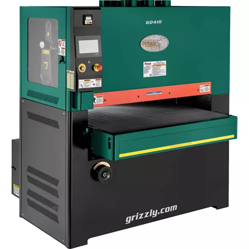

G0410 43" 25 HP 3-Phase Extreme Series Wide-Belt Sander
Deliver consistent, high-quality sanding across workpiece types and sizes in fast-paced production environments.
Get your professional woodworking shop up to full speed by adding this wide-belt sander to your equipment lineup.
Fitted with a robust 25 HP motor, the sander turns out top quality, consistently smooth workpieces so you can meet every deadline.
Special options on this 43" wide-belt sander include a VFD for variable-speed operation, user-friendly touch screen controls, thickness sensor, clear side window, and interior lighting.
This sander is ready to boost productivity whether you are sanding identical boards for large-volume production, creating uniform thicknesses for glued-up panels, or preparing veneered sheets for finishing.
FEATURES & BENEFITS:
  • Touch-screen controls for motors, sanding drum, conveyor, and table elevation
  • Material thickness sensor automatically adjusts the table to the thickness of your workpiece
  • Plexiglass side window and interior lights for easy viewing of sanding belt tracking
  • Variable-speed feed conveyor for adaptability and optimal sanding results
  • Pneumatic belt tracking and tensioning to maintain the perfect pressure for accurate sanding
  • Amp/load meter to prevent excessive loads while maximizing machine capacity
  • Built-in air regulator/water separator to protect pneumatic components
  • Rubber infeed and outfeed pressure rollers prevent uneven sanding and dampen vibration
  • Disc brake, emergency stop bar, and stop switch for optimal safety
  • Main motor: 25 HP, 220V/440V*, 3-phase, 64.9A/32.5A
  • Conveyor feed motor: 2 HP, 6A/3A
  • Table elevation motor: 1/4 HP, 1.2A/0.6A
  • Maximum board width: 43"
  • Maximum board thickness: 6"
  • Minimum board length: 14"
  • Minimum board thickness: 3/16"
  • Conveyor speed: 14-60 FPM
  • Sanding belt speed: 3543 FPM front, 2565 FPM rear
  • Sanding belt size: 43" x 60"
  • Sanding belt oscillations: 35-40 OPM
  • Air requirement: 75 PSI
  • Footprint: 61-1/2" x 31"
  • Overall dimensions: 63" W x 60" D x 68" H
  • Approximate shipping weight: 3418 lbs.
Built for busy shops, this 43" 25 HP 3-phase wide-belt sander is ready for maximum impact on your bottom line.
Our U.S.-based Technical Documentation Department produces detailed owner's manuals and instruction sheets, empowering your team to optimize equipment performance and minimize downtime.
Comprehensive U.S.-Based Support:
Our experts provide a full range of support services including troubleshooting, maintenance tips, and parts sourcing. The 1-year warranty on the G0410 safeguards your investment, offering peace of mind and ensuring long-term reliability.
*This machine is prewired for 220V. We can rewire to 440V in a few days’ time for a fee. Please contact Grizzly Technical Support at (570) 546-9663 before placing your order.
