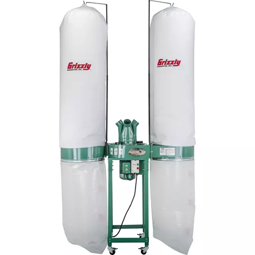

G0672 5 HP Industrial Dust Collector
A large horsepower, mobile dust collector for industrial settings.
From its gutsy 5 HP motor to its huge 15" impeller, this powerhouse will tackle any dust collection task you throw at it—day in and day out.
With four connection ports, the G0672 5 HP Industrial Dust Collector can easily handle four simultaneously running woodworking machines in a large-sized shop.
The G0672 has an air suction capacity of 3961 CFM and has a max static pressure of 14.6" at 0 CFM.
Static pressure is produced by the 15" steel impeller to move the wood chips into the collector.
The G0672 features a 2.5-micron upper filter top bag to capture the fine dust particles that normally end up all over your shop.
The steel base has been fitted with casters for mobility in your garage or shop.
Like all Grizzly dust collectors, the G0672 comes with a one-year warranty which covers parts and assures the unit is free from factory defects.
The G0672 manual was written by our U.S. based Technical Documentation Department and is packed with useful information.
The complete and easy-to-read manual provides full instructions on how to assemble and maintain your dust collector.
Parts and accessories for the dust collector may be available online and shipped from the Grizzly parts warehouse in Springfield, MO.
  • Motor: 5 HP, 220V, single-phase, 34A
  • Airflow capacity: 3961 CFM
  • Maximum static pressure: 14.6"
  • Impeller: 15" balanced steel, radial fin
  • Filtration rating: 2.5-micron
  • Intake port with manifold: four 4" ports
  • Intake port without manifold: 10"
  • Simultaneous machine collection capacity: 4
  • Collection bag capacity: 179-1/2 gal.
  • Bottom bag material: plastic
  • Bottom bag size: 23-5/8" x 54"
  • Overall dimensions: 74" W x 29" D x 134" H
  • Approximate shipping weight: 326 lbs.
Optional bag replacement: T21317 24" X 70" 2.5-Micron Polyester Filter Bag; G6512 6mm Plastic Lower Bag.
  • 2.5-Micron upper bag filtration
  • 15" Balanced steel, radial fin impeller
  • Heavy-duty steel stand with 3" casters and brakes
  • Sturdy collection bags with 24 cu. ft. total capacity
  • Four port intake manifold for even distribution to collection bags
