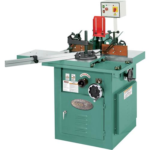

G8622 5 HP Sliding Table Shaper with Tilting Spindle
A versatile shaper with plenty of power.
Increase your shaper production abilities with the G8622 5 HP Sliding Table Shaper thanks to the sliding table and tilting spindle.
Now, even the most complicated profiles can be made quickly, consistently and safely on all sides and sizes of workpiece.
The G8622 is intended for heavy-duty professional use; it features a 5 H.P. single-phase motor, 220V operation with magnetic power switching, and full reversing capabilities.
It handles cutters up to 5-7/8" diameter by 5-1/8" tall. The four speed V-belt drive system lets you slow down those big cutters from 10,000 RPM to 3600 RPM.
The G5912Z comes with three interchangeable spindles 3/4", 1", and 1-1/4" plus three table inserts 7" OD x 3-1/2" ID, 3-1/2" OD x 3" ID, and 3" OD x 2"ID.
Like all Grizzly shapers, the G8622 comes with a 1-year warranty which covers parts and assures the unit is free from factory defects. (Consumables are not covered by the warranty.)
The G8622 manual was written by our U.S. based Technical Documentation Department and is packed with useful information. The complete and easy-to-read manual makes it easier to assemble and maintain your shaper.
The Grizzly Customer Service and Technical Support Teams are U.S. based. Parts and accessories for the shaper may be available online and shipped from the Grizzly parts warehouse in Springfield, MO.
  • Motor: 5 HP, 220V, single-phase, 25A
  • Maximum cutter height: 5-1/8"
  • Maximum cutter diameter: 5-7/8"
  • Spindle diameters: 3/4", 1", 1-1/4"
  • Spindle lengths: 6" - 7"
  • Spindle capacity under nut: 4-1/4", 4-5/8", 5-1/8"
  • Spindle speeds: 3600, 5100, 8000, 10,000 RPM
  • Spindle travel: 3-1/4"
  • Spindle tilt: 0–45°
  • Spindle openings: 2", 3", 3-1/2", 7"
  • Table size: 14-7/8" x 35-1/2"
  • Floor-to-table height: 34-3/4"
  • Table counterbore: 7" dia. x 5/8" deep
  • Sliding table size: 13-1/4" x 35-1/2"
  • Sliding table travel: 21-7/8"
  • Footprint: 25-1/2" x 27"
  • Overall dimensions: 35-1/2" W x 42-1/2" D x 45-1/2" H
  • Approximate shipping weight: 834 lbs.
  • Cast-iron miter gauge adjustable 60° left to right
  • Fence adjustment includes built-in ratchets and knob-equipped adjusters
  • Extruded aluminum miter fence with adjustable stop block
  • Lever-actuated stock hold-down
  • Spindles include spacer and nuts
  • Spindle height scale in inches and millimeters
