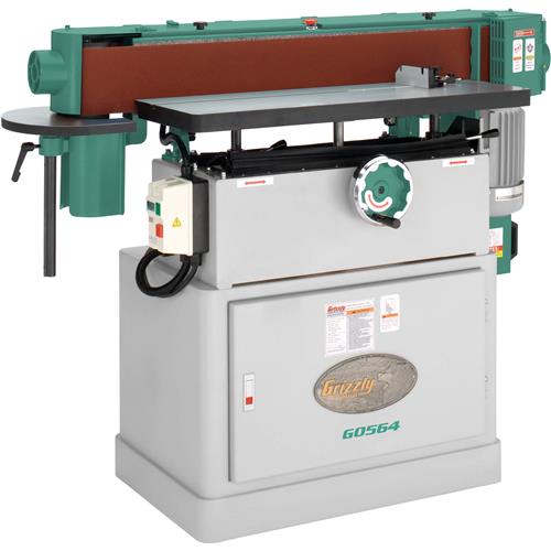

G0564 6" x 108" Oscillating Edge Sander
For all-around versatility in a sanding machine, you can’t beat an oscillating edge sander.
The G0564 6" x 108" Oscillating Edge Sander comes with a powerful 3 HP motor for handling all-day use in production shops.
It offers a large sanding surface combined with an oscillating belt and a large precision-ground cast-iron table for efficient edge-sanding.
The edge-sanding table is handwheel-controlled for vertical adjustment and angle sanding is much easier to manage since the sanding belt tilts instead of the table.
The sanding belts are 6" wide by 108" long. A full range of replacement belts are available.
The G0564 comes with a spindle sanding attachment for sanding curved surfaces.
For improved dust collection, the T10116 Auxiliary Dust Table can replace the existing end table.
Four interchangeable spindle drums from 1-1/2" to 4-1/2" for contour sanding are included.
An emergency stop button is conveniently located on top of the sander should an emergency occur during use of the sander.
The G0564 manual was written by our U.S.-based Technical Documentation Department and is packed with useful information. The complete and easy-to-read manual makes it easier to assemble and maintain your edge sander.
CSA certified
  • Motor: 3 HP, 240V, single-phase, 11A
  • Sanding belt speed: 3150 FPM
  • Sanding belt size: 6" x 108"
  • Sanding belt oscillation stroke: 1/4"
  • Sanding belt tilt: 90°
  • Table size: 35-1/2" x 12"
  • Table travel: 4"
  • End table size: 10" x 11-1/2"
  • End table travel: 10"
  • Platen with graphite pad: 6-3/4" x 39-3/4"
  • Platen tilt: 0–90°
  • Drive roller diameter: 7"
  • Idler roller diameter: 3-7/8"
  • Spindle drums: 1-1/2", 2", 3" x 4-1/2" L
  • Overall dimensions: 60" W x 28" D x 49" H
  • Approximate shipping weight: 597 lbs.
  • Sanding surface tilts vertical to horizontal
  • T-Slot table and miter gauge
  • Quick-release belt tension lever
  • Graphite-coated platen
  • Platen tilts 0 to 90° (5° scale)
  • Oscillating sanding surfaces
  • Precision-ground cast-iron tables
  • Two 4" dust ports
  • Shielded and permanently lubricated ball bearings
