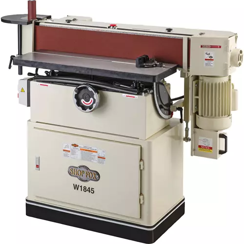

Shop Fox W1845 6" x 108" Oscillating Edge Sander
Built for production sanding operations, this sander gets things done quickly.
With an ability to position the platen horizontally or vertically, sanding operations of the W1845 6" x 108" Oscillating Edge Sander are variable between 0–90°.
Not only does it produce glass-like smooth surfaces, it also doubles as an oscillating spindle sander with three spindle drum sizes for contour sanding.
The tables are precision-ground cast-iron and adjustable to ensure even wear across the entire belt (or drum) for maximum life and value.
Sanding belts are 6" wide by 108" long.
A full range of replacement belts are available.
Top it off with, a belt speed of 3150 FPM, effective dust-capturing hoods, and built-in storage, and you've got the ultimate in oscillating edge sanders.
The W1845 manual was written by our U.S.-based Technical Documentation Department and is packed with useful information. The easy-to-read manual provides full instructions on how to assemble and maintain your sander.
  • Motor: 3 HP, 240V, single-phase, 11A
  • Sanding belt size: 6" x 108"
  • Sanding belt speed: 3150 FPM
  • Sanding belt oscillation stroke: 1/4"
  • Table size: 35-1/2" x 12"
  • Table travel: 4"
  • Aux. table size: 10" x 11-1/2"
  • Aux. table travel: 10"
  • Drive roller diameter: 7"
  • Idler roller diameter: 3-7/8"
  • Platen size: 6-3/4" x 39-3/4"
  • Platen tilt: 0-90 deg. (5 deg. scale)
  • Footprint: 32"L x 19-1/2"W
  • Overall dimensions: 60" W x 28" D x 49" H
  • Approximate shipping weight: 597 lbs.
  • Two-year warranty!!
  • Sanding surfaces tilt vertical and horizontal
  • T-slot table, fence, and miter gauge
  • Quick-release belt tension lever
  • Graphite-coated platen
  • Oscillating sanding surfaces
  • Precision-ground cast-iron tables
  • 1-1/2", 2", and 3" diameter sanding drums
  • Shielded and permanently lubricated ball bearings
  • Two 4" dust ports
