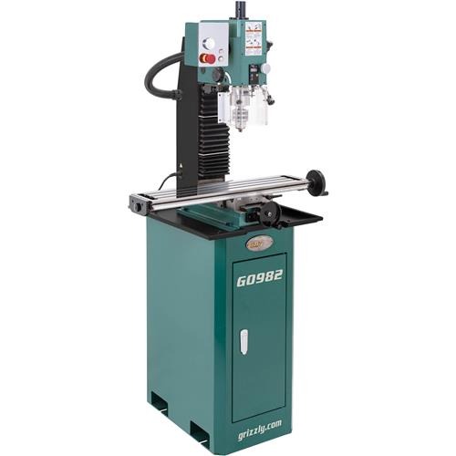

G0982 6" x 27" Variable-Speed Mill/Drill With Stand
A feature-packed milling machine with essential automation to boost your production capacity.
This efficient mill/drill is an ideal option for a small metalworking shop, and it includes all the options needed for milling, drilling, and tapping so you can complete every project easily.
The most unique feature of this exceptional machine is the exclusive display; it offers a mirror finish when off and easy-to-view backlit LED display when on. This machine will be a visual stand-out in your workshop!
Digital readouts for spindle speed and depth make it easy to check and adjust settings quickly as you work; the unit also includes a helpful temperature display.
The coarse and fine spindle downfeed options allow for versatility and ease in switching between feed types.
Stability and precision are guaranteed with the dovetail headstock column and table ways, providing rigidity for your milling and drilling processes.
With easy-to-use controls you can complete every function with minimal delays.
A front-mounted E-stop button increases safety by allowing you to immediately stop the machine when needed.
The G0982 manual was written by our U.S.-based Technical Documentation Department and is packed with useful information.
  • Motor: 1 HP, 110V, single-phase, 11A
  • Spindle taper: R-8
  • Maximum distance spindle to table: 12-3/8"
  • Maximum distance spindle to column: 6-1/2"
  • Spindle travel: 2-3/4"
  • Spindle speed: Variable, 100-2000 RPM
  • Vertical head travel: 9-1/4"
  • Table size: 6-3/8" x 27-1/2"
  • Table travel (longitudinal): 19-3/4"
  • Table travel (cross): 6-1/16"
  • T-slots: 3 @ 1-9/16" centers, 12mm wide
  • Drilling capacity cast-iron: 3/4"
  • Drilling capacity mild steel: 5/8"
  • End milling capacity: 5/8"
  • Face milling capacity: 2"
  • Footprint: 22" x 14-1/2"
  • Overall dimensions: 34-1/2" x 24-1/2" x 65-1/2"
  • Approximate shipping weight: 360 lbs.
  • Specialized mirror display – mirror finish when OFF and backlit LED view when ON
  • Spindle depth and spindle speed DROs
  • Coarse and fine spindle downfeed
  • Dovetail headstock column and table ways
  • Temperature display
  • Front-mounted E-stop button
  • 1-year limited warranty
