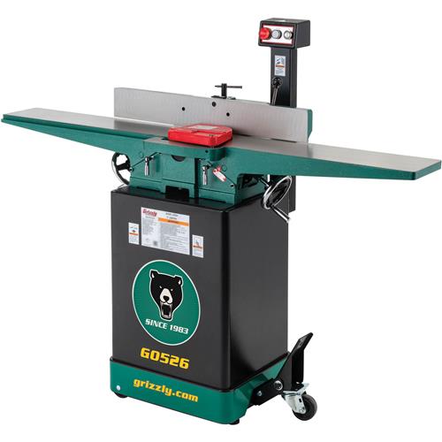

Image for Grizzly G0526 - 6" x 60" Jointer w/ V-Helical Cutterhead

G0526 6" x 60" Jointer w/ V-Helical Cutterhead
Achieve professional results with this precision jointer that features a 60" long bed.
This is the ultimate jointer for small shops and hobbyists looking to expand their woodworking capabilities and build with confidence! With a 60" precision-ground cast-iron table you get increased support for longer workpieces – giving you flexibility to take on bigger projects.
Get absolutely pristine, tear-out free finishes with the 4-row, 6" V-helical cutterhead that includes 24 indexable carbide inserts. The shearing angle of these inserts, combined with the “V” formation of the rows, gives cleaner cuts and the smoothest, quietest operation of any cutterhead type.
This feature-packed jointer also comes with a heavy-duty precision-ground cast-iron fence and a rabbeting outfeed table; easily adjust the tables to parallel with the precision gib adjustment. For convenience, the machine includes a built-in mobile base - quickly move the jointer to wherever you need it in your shop.
This is the high-performance jointer your woodworking shop needs for consistent, smooth, accurate cuts, with the added unique touch of a custom black and green paint scheme.
