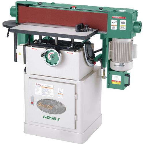

G0563 6" x 89" Oscillating Edge Sander
For all-around versatility in a sanding machine.
The G0563 6" x 89" Oscillating Edge Sander packages features to satisfy small and large productions shops alike.
The large sanding surface combined with an oscillating belt and a large precision-ground cast-iron table allow for efficient edge-sanding.
Angle sanding is much easier to manage since the sanding belt tilts instead of the table.
The edge-sanding table is handwheel-controlled for vertical adjustment.
The sanding belts are 6" wide by 89" long. A full range of replacement belts are available.
The G0563 comes with a spindle sanding attachment for sanding curved surfaces.
It includes four interchangeable spindle drums from 1-1/2" to 4-1/2" for contour sanding.
For improved dust collection, the T10116 Auxiliary Dust Table can replace the existing end table.
Should an emergency occur during use of the sander, an emergency stop button is conveniently located on top of the sander.
The G0563 manual was written by our U.S. based Technical Documentation Department and is packed with useful information. The complete-and-easy to read manual makes it easier to assemble and maintain your saw.
CSA certified
  • Motor: 2 HP, 240V, single-phase, 9A
  • Sanding belt speed: 3150 FPM
  • Sanding belt size: 6" x 89"
  • Sanding belt oscillation stroke: 1/4"
  • Sanding belt tilt: 90°
  • Table size: 26-7/8" x 12"
  • Table travel: 3-3/4"
  • End table size: 10" x 11-1/2"
  • End table travel: 10"
  • Platen with graphite pad: 6-3/4" x 30-1/4"
  • Platen tilt: 0–90°
  • Drive drum diameter: 7"
  • Idler roller diameter: 3-7/8"
  • Spindle drums: 1-1/2", 2", 3" x 4-1/2"
  • Footprint: 22-1/2" x 19-1/2"
  • Overall dimensions: 50-1/2" W x 23" D x 49" H
  • Approximate shipping weight: 504 lbs.
  • Sanding surface tilts vertical to horizontal
  • T-Slot table and miter gauge
  • Quick-release belt tension lever
  • Graphite-coated platen
  • Platen tilts 0 to 90° (5° scale)
  • Oscillating sanding surfaces
  • Precision-ground cast-iron tables
  • Two 4" dust ports
  • Shielded and permanently lubricated ball bearings
  • Four interchangeable spindle drums for contour sanding
