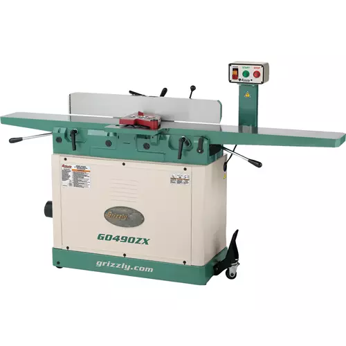

G0490X 8" x 76" Jointer with Parallelogram Beds and Spiral Cutterhead
Ensure smooth stock preparation.
Achieve exceptional precision and efficiency with the G0490ZX 8" Jointer, featuring innovative design and cutting-edge technology for superior results including:
4-Row Spiral Cutterhead: Get better finishes, smoother operation, and easier maintenance than straight-knife cutterheads. 40 razor-sharp indexable carbide inserts can be rotated up to 3 times to expose a new sharp edge.
Parallelogram Table Adjustment: The versatile parallelogram table adjustment mechanism moves with four points of contact. This makes table adjustments smoother and more precise, even with long and heavy cast-iron tables. It also keeps the tables closer to the cutter, which adds a degree of safety during operation.
Extended Infeed Table: Spanning over 43", the generously sized infeed table simplifies surfacing longer stock with ease.
User-Friendly Adjustments: Swiftly alter table height using the easy-to-operate table elevation lever and utilize the depth gauge for convenient reference.
Edge-Jointing Excellence: The 5" tall, center-mounted fence excels at edge-jointing wide stock.
Efficient Power Transmission: With a poly-V serpentine belt and pulley system, the jointer maximizes power efficiency while minimizing maintenance requirements.
Mobility and Versatility: The cabinet stand is equipped with a built-in mobile base, allowing you to effortlessly move this substantial machine around your workshop to suit your needs.
This 8" jointer boasts additional features, including a 4" dust port, precision-ground cast-iron tables, shielded and lubricated bearings, and poly-V serpentine belt and pulley system.
When the time comes, the H7319 are the 14mm x 14mm x 2.0mm replacement inserts needed.
A top choice for serious woodworkers looking for quality and precision.
  • Motor: 3 HP, 220V, single-phase, 14A
  • Maximum width of cut: 8"
  • Maximum depth of cut: 1/8"
  • Maximum rabbeting depth: 1/2"
  • Cutterhead diameter: 3-3/8"
  • Cutterhead type: 4-row spiral
  • Insert size, type: 14 x 14 x 2mm, indexable carbide
  • Cutterhead speed: 5409 RPM
  • Table size: 8" x 76"
  • Fence size: 5" x 36"
  • Minimum stock length: 10"
  • Dust port size: 4"
  • Footprint: 44-1/2" x 16-1/2"
  • Overall dimensions: 76-1/2" W x 24" D x 45-1/2" D
  • Approximate shipping weight: 593 lbs.
