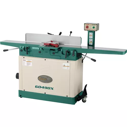

G0490X 8" x 76" Jointer with Parallelogram Beds and Spiral Cutterhead
The next level in 8" jointers.
Professionals and hobbyist woodworkers alike, you can't go wrong with the exceptional value of the G0490X 8" x 76" Jointer with parallelogram tables and 4-row spiral cutterhead.
With the spiral cutterhead, dealing with dull or nicked edges is as easy as loosening screws and turning any of the 40 carbide inserts to a fresh edge. This process will reduce tearout and save you time over sharpening and resetting straight knives like a traditional jointer cutterhead requires.
This parallelogram jointer features an infeed table over 43" that is helpful for surfacing longer stock. With the parallelogram table setup, the four points of contact allow for easy adjustment of each table for perfect alignment.
The easy-to-use lever-controlled table elevation quickly adjusts the table height. The 5" tall, center-mounted fence is amazing for edge-jointing wide stock. The built-in mobile base allows you to easily move this beast around the shop as needed.
