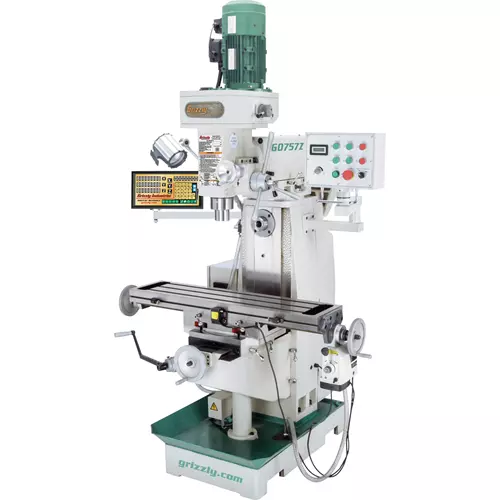

Grizzly G0757Z - 9" x 39" 3 HP Variable-Speed Horizontal/Vertical Mill with DRO
5.0 (5)
$13,575.00
  • Motor: 3 HP
  • Table size: 39-3/8 in. x 9-1/2 in.
  • Longitudinal travel: 23-1/2 in.
  • Cross travel: 8-1/2 in.
  • Spindle taper: R-8
  • Max spindle to table: 14-1/2 in.
  • Max spindle to column: 26-3/4 in.
  • Shipping weight: 2050 lbs.
G0757Z 9" x 39" 3 HP Variable-Speed Horizontal/Vertical Mill with DRO
Uncompromised power and capability in a feature-packed mill.
The G0757Z 9" x 39" 3 HP Variable-Speed Horizontal/Vertical Mill boasts vertical and horizontal spindles, each with their own dedicated motor.
The motor has an independent, high-CFM fan to keep it cool during operations requiring slow-speed or intense demands.
Convert the mill to the horizontal setup by rotating the head 180° on the column and installing either of the two included horizontal arbors.
This versatile mill features convenient, electronic variable-speed spindle control with a digital readout.
Additionally, this machine features a built-in coolant system, LED work light, and a wide range of spindle speeds.
  • Required power source: 220V, single-phase, min. 15A circuit
  • Vertical spindle motor: 3 HP, 220V
  • Horizontal spindle motor: 2 HP, 220V
  • Vertical spindle speeds: Variable, 100–2000 RPM
  • Horizontal spindle speeds: 8, 72–1300 RPM
  • Spindle travel: 5"
  • Table size: 9-1/2" x 39-3/8"
  • Table travel (longitudinal): 23-1/2"
  • Table travel (cross): 8-1/2"
  • Knee travel (vertical): 12-1/2"
  • Table rotation: 45° L/R
  • Head turret/column swivel: 180°
  • Head tilt: 90° L/R
  • T-slots: Three 5/8" slots, 3" on center
  • Overall dimensions: 53-1/2" W x 55" D x 82" H
  • Approximate shipping weight: 2050 lbs.
  • Variable-speed spindle control with digital readout for spindle RPM
  • 3-Axis DRO
  • Recycling coolant system
  • Longitudinal power feed
  • High-precision P5 spindle bearings
  • LED work light
  • 1-year limited warranty
