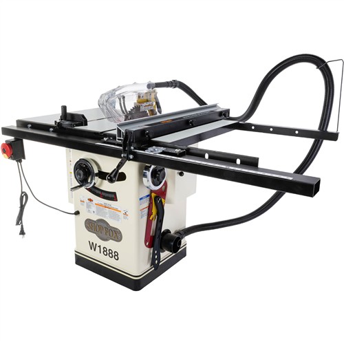

Shop Fox W1888 - 10" Cabinet Table Saw
4.1 (27)
$2,925.00
  • Motor: 2 HP
  • Table saw type: Cabinet Table Saw
  • Blade size: 10 in.
  • Maximum cutting height @ 90deg: 3-1/8 in.
  • Maximum cutting height @ 45deg: 2-1/8 in.
  • Maximum ripping capacity - right: 31 in.
  • Table type: Precision-Ground Cast Iron
  • Overall table size: 40-1/8 in. x 27 in.
  • Shipping weight: 449 lbs.
Shop Fox W1888 10" 2 HP 115V/230V Cabinet Table Saw with Dual-Port Dust Collection
The W1888 isn't just a table saw, it's an investment.
This machine is meticulously designed for the passionate woodworker who demands top-notch performance. It has the perfect balance of power to tackle tough cuts, precision for clean results, and affordability to fit your budget.
Engineered for Excellence:
  • 2 HP TEFC Motor: Delivers superior power to handle hardwoods and thick materials with ease. Selectable voltage (115V or 230V) allows for optimization of power and efficiency.
  • Cast-Iron Construction: The W1888 boasts a cast-iron table, trunnions, and fence for unwavering stability and vibration dampening. This translates to cleaner cuts and a longer lifespan for the saw.
  • Micro-Adjustable Fence System: The two-position fence system with micro-adjustments ensures precise rips, down to the finest fractions of an inch.
  • Superior Dust Collection: The internal dust shroud and fully-enclosed blade guard with a 4" dust port work in tandem to capture dust particles at the source, keeping your workspace clean and healthy.
Additional Features:
  • Easy-glide fence system for smooth adjustments
  • Heavy-duty miter gauge for accurate angle cuts
  • Poly-V drive belt for reduced noise and vibration
  • Safety paddle switch with disabling key
  • Two-year warranty for peace of mind
The W1888 manual was written by our U.S.-based Technical Documentation Department and is packed with useful information. The complete and easy-to-read manual makes it easier to assemble and maintain your saw.
CSA certified
20A Minimum Circuit Requirement
  • Motor: 2 HP, 115V/230V (prewired 115V), single-phase, 16A/8A
  • Rip capacity: 31-1/2" right, 11-3/8" left of blade
  • Maximum depth of cut @ 90°: 3-1/8"
  • Maximum depth of cut @ 45°: 2-1/8"
  • Overall table dimensions: 40-1/8" x 27"
  • Distance from front of table to center of blade: 16-1/4"
  • Floor-to-table height: 34-1/4"
  • Arbor diameter: 5/8"
  • Arbor speed: 4000 RPM
  • Max width of dado: 13/16"
  • Dust port size: 4"
  • Footprint: 19-1/2" x 20-1/2"
  • Overall dimensions: 66" W x 40" D x 48" H
  • Approximate shipping weight: 449 lbs.
*This machine is prewired for 115V operation. 230V operation requires purchase and installation of conversion kit PX1888224X.
