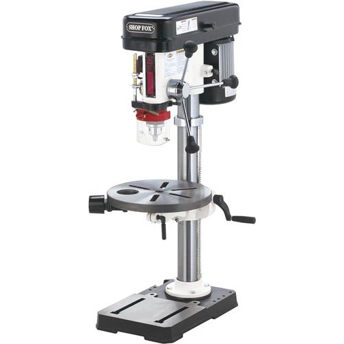

W1668 13-1/4" Oscillating Drill Press
With the oscillating motion, this is much more than just a benchtop drill press.
The Shop Fox W1668 13-1/4" Oscillating Drill Press was awarded Top Value by WOOD Magazine because of its versatility.
The W1668 can be used for efficient contour sanding in addition to traditional drilling, saving you the cost of buying a separate sander.
As one grizzly.com customer review mentions, “this Benchtop Oscillating Drill Press is a good compromise for a small shop without room for two separate devices.”
The W1668 is fitted with a 1 to 16mm JT33 keyed drill chuck, offers up to 3-1/8" of travel, and a drilling capacity of 5/8" through mild steel.
With the oscillating feature, the oscillating stroke length is 3/4".
The 12-3/8" diameter, round table allows for drilling and surface sanding at different angles as it tilts 90° in both directions.
The table has a clearance hole for use while sanding. This clever design incorporates a 2" dust collection port so that sanding is less messy.
