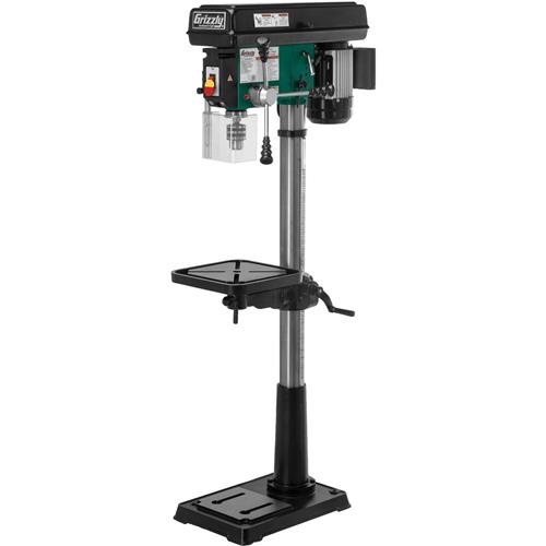

T34610 17" Floor Drill Press w/ LED Light & Laser
Achieve precision drilling results with this powerful, stable drill press.
Tackle complex cabinet builds, complete detailed fabrication processes, or even create custom projects with this versatile floor drill press.
Laser line guides and an LED light help prevent drilling errors and ensure consistency for your DIY, hobby, and custom projects.
A push-button spindle depth stop allows you to set the depth for consistent repeat drilling operations.
It features a durable chuck guard for safety and a convenient chuck key holder to keep track of your chuck key.
The cast-iron table offers essential stability for consistent, high-quality drilling results without excessive wear to the machine.
FEATURES & BENEFITS:
  • Laser Line Guides: Adjustable Class II guides ensure precision drilling to avoid mistakes and material waste.
  • LED Light: Increases visibility for better results and improved safety.
  • Depth Stop: Provides simple adjustments and ensures consistent drilling depth.
  • Chuck Guard: Adds another layer of protection from drilling debris.
  • Chuck Key Holder: Avoid misplacing your chuck key and keep it within reach.
  • Precision-Ground Cast-Iron Table: Durable construction to withstand extensive use.
  • SPECIFICATIONS:
  • Motor: 1-1/2 HP, 120V, single-phase, 9.9A
  • Swing: 17"
  • Spindle taper: MT#2
  • Spindle travel: 3-1/8"
  • Spindle speeds: 16, 210-3630 RPM
  • Drill chuck: JT3 keyed, 5/8"
  • Drilling capacity: 3/4" Mild steel
  • Maximum distance from spindle to table: 26-3/8"
  • Table dimensions: 12-3/8" x 12-3/8"
  • Table tilt: 0-45° L/R
  • Table swivel around column: 360°
  • T-slots (x4): 15mm
  • Footprint: 20" x 13-1/2"
  • Overall dimensions: 15-1/2" W x 27-1/2" D x 63-1/2" H
  • Approximate shipping weight: 174 lbs.
  • Get accuracy, power, and versatility for every build with this 17" floor model drill press.
