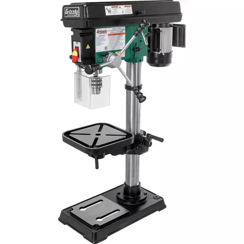

T34608 15" Benchtop Drill Press w/ LED Light & Laser
Get consistent, accurate drilling results combined with convenient benchtop operation.
Save shop space and keep costs down with this benchtop drill press that provides all the benefits of a full-sized, higher cost machine.
Laser line guides and an LED light help prevent drilling errors for consistent results on your DIY, hobby, and custom projects.
A push-button spindle depth stop allows you to set the depth for consistent repeat drilling operations.
It features a durable chuck guard for safety and a convenient chuck key holder to keep track of your chuck key. The cast-iron table offers essential stability for consistent, high-quality drilling results without excessive wear to the machine.
FEATURES & BENEFITS:
  • Laser Line Guides: Adjustable Class II guides ensure precision drilling to avoid mistakes and material waste.
  • LED Light: Increases visibility for better results and improved safety.
  • Depth Stop: Provides simple adjustments and ensures consistent drilling depth.
  • Chuck Guard: Adds another layer of protection from drilling debris.
  • Chuck Key Holder: Avoid misplacing your chuck key and keep it within reach.
  • Precision-Ground Cast-Iron Table: Durable construction to withstand extensive use.
  • SPECIFICATIONS:
  • Motor: 3/4 HP, 120V, single-phase, 5.3A
  • Swing: 15-1/4"
  • Spindle taper: MT#2
  • Spindle travel: 3-1/8"
  • Spindle speeds: 12, 250–3100 RPM
  • Drill chuck: JT3 keyed, 5/8"
  • Drilling capacity: 5/8" Mild steel
  • Maximum distance from spindle to table: 18-1/4"
  • Table dimensions: 10-9/16" x 10-9/16"
  • Table tilt: 0-45° L/R
  • Table swivel around column: 360°
  • T-slots (x4): 15mm
  • Footprint: 19-1/2" x 12"
  • Overall dimensions: 14-1/2" W x 26" D x 42" H
  • Approximate shipping weight: 127 lbs.
  • Make quick progress on creative and home improvement projects with this sturdy, portable drill press.
    Grizzly owner's manuals and instruction sheets are produced by our U.S.-based Technical Documentation Department and are packed with useful information. Parts may be available online and are shipped from the Grizzly parts warehouse in Springfield, MO.
    Need help? We offer U.S.-based customer service and technical support to get your questions answered and help keep your equipment running in top condition. And to ensure your satisfaction, the T34608 comes with a 1-year warranty.
