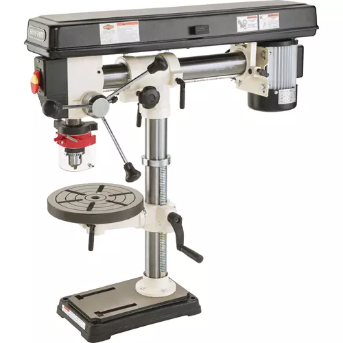

W1669 34" Benchtop Radial Drill Press
A tilting head benchtop drill press for adjustable angled drilling.
The Shop Fox W1669 34" Benchtop Radial Drill Press boasts a 1/2 HP motor that smoothly powers the five spindle speeds ranging from 550 to 3000 RPM.
The headstock can be tilted 45° left, 90° right, and slid forward or backward over the column allowing you full adjustability.
To make sure that you get the best use of the 9-3/4" diameter table. The drill press features rack-and-pinion elevation controls—adjustable 9-1/2" vertically, 90° tilt (left and right) and is capable of 360° rotation around the column.
The W1669 can easily drill holes through plastic, fiberglass, and composites, and has a maximum capacity to drill through a half inch of steel without bogging down.
The JT33 keyed drill chuck is fitted to the JT-33 spindle taper and offers up to 3-1/4" of travel. The chuck accepts drill bits from 1/16" to 5/8". You can set the adjustable threaded depth stop for predetermined and repeatable drilling.

  • Motor: 1/2 HP, 120V, single-phase, 4.7A
  • Swing: 34"
  • Drill chuck: 1/16"–5/8"
  • Drilling capacity: 1/2" mild steel
  • Spindle taper: JT-33
  • Spindle travel: 3-1/4"
  • Number of speeds: 5, 550–3000 RPM
  • Column diameter: 2.360"
  • Table size: 9-3/4" diameter
  • Table swing: 360°
  • Table tilts: 90° L/R
  • Table T-slots: 6 @ 5/8"
  • Head tilt: 45 degrees left, 90 degrees right
  • Footprint: 8-1/2" W x 13-1/2" L
  • Overall size: 12" W x 33-1/2" D x 31-1/2" H
  • Approximate shipping weight: 98 lbs.
  • Two-year warranty!!
  • Horizontal sliding headstock
  • Threaded depth stop
  • Crank handle operated rack-and-pinion vertical table movement
  • Table has lock levers
  • Radial design allows angle drilling
  • Cushioned grip quill handles
