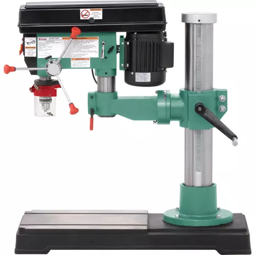

G9969 45" Radial Drill Press
A popular drill press for both wood and metalworking shops that have bulky projects.
The swing on the G9969 45" Radial Drill Press is a huge 45" (you can drill in the middle of a 45" diameter piece).
For added adjustability, the headstock can be rotated 360° around the column, can swivel 360° in place, and can tilt 45° to the left or the right.
The G9969 boasts a 1 HP motor that smoothly powers the 12 spindle speeds ranging from 140 to 3050 RPM. The low RPM speed is vital to drilling metal.
The spindle can be brought close to the column with the uniquely designed swivel post.
The drill press features rack-and-pinion elevation controls—adjustable 20-1/2" vertically.
Prewired for 110V, 45" Radial Drill Press can plug into a standard 110V wall receptacle or can be converted to operate on a 220V power supply.
Ready for industrial use, the t-slots in table allow you to use a variety of clamping options.
The G9969 has a depth stop that allows you to drill repeated non-through holes to the same depth every time.
Enjoy getting the most out of your bulky projects with all the features the G9969 provides.
