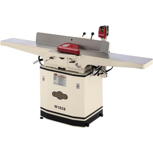

Shop Fox W1858 8" x 72" Dovetail Jointer w/ Helical Cutterhead & Mobile Base
All the best features on an 8" jointer.
The W1858 Jointer is a feature-packed machine with so much to offer, especially the 4-row helical cutterhead with 36 indexable carbide inserts.
The inserts slice through wood at an angle to achieve a sheering effect. You’ll get quieter operation, and most importantly, a significantly better finish with less tear-out.
Each insert can be rotated three times to expose a new, sharp edge. They don't require finicky adjustment and setup that traditional straight-knife jointers do. You'll save valuable time and money from the start.
The 9" x 72" precision-ground cast-iron table is ready to surface plane, edge joint, bevel joint, and square stock.
The tables are easily adjusted by heavy-duty cast-iron handwheels and move along dovetail ways.
The easy-to-use fence has built-in stops to simplify adjustments between 45°, 90°, and 135°.
Additional features include a thermal protection switch, built-in mobile base, and integrated 4" dust port.

  • Motor: 3HP, 230V, single phase, 12A
  • Maximum width of cut: 8"
  • Maximum depth of cut: 1/8"
  • Maximum rabbeting depth: 1/2"
  • Minimum stock length: 10"
  • Cutterhead diameter: 3-1/16"
  • Insert size: 15 x 15 x 2.5 mm
  • Cutterhead speed: 5500 RPM
  • Total table size: 9" x 72"
  • Fence size: 4-5/8" x 38"
  • Fence system: positive stops
  • Overall dimensions: 72-1/2" W x 25-1/2" D x 42" H
  • Approximate shipping weight: 373 lbs.
  • Two-year warranty!!
  • Super long 6' table
  • Center mounted fence
  • Built-in mobile base with internally-mounted, non-directional casters
  • Beds slide on dovetailed ways
  • Rabbeting table
  • Handwheel-adjustable tables with depth gauge
