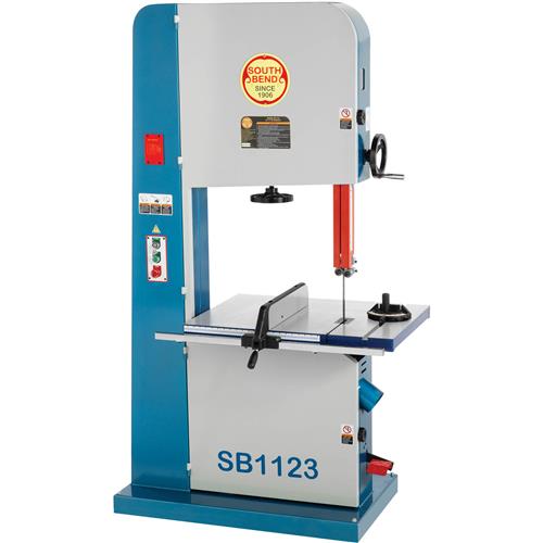

SB1123 24" Industrial-Duty 7-1/2 HP Resaw Bandsaw
Precision, power, and capacity for high-output, industrial use.
The professional-level, high-production SB1123 24" Industrial-Duty 7-1/2 HP Resaw Bandsaw from South Bend is a top-end powerhouse with its massive 24-3/8" throat and 16-1/8" resaw capacity, powered by a 7-1/2 HP motor.
It’s the largest capacity, most impressive wood-cutting bandsaw South Bend offers–built to meet the demanding needs for industrial production work.
Dual ball-bearing blade guides and rack-and-pinion table adjustments provide precision and ease of use.
The computer-balanced cast-iron wheels, an extra-large 23-5/8" by 33-1/2" x 2" thick precision-ground cast-iron table, and cast-iron trunnions all work together to minimize vibration.
The table tilting mechanism is the strongest in the industry, allowing you to put the heaviest loads on the table without losing squareness. This saw is a true joy to use!
For a full range replacement and resaw blades for the SB1123, shop here.
If unstoppable power and large capacity are a must for your production shop, there is simply not a better saw on the market to meet your demands.

  • Motor: 7-1/2 HP, 220V/440V* (prewired 240V), 3-phase, 20A/10A
  • Minimum circuit size: 30A @ 220V, 15A @ 440V
  • Throat (max. width left of blade): 24-3/8"
  • Resaw capacity: 16"
  • Table size: 23-5/8" x 33-1/2"
  • Table tilt: -5° L–45° R
  • Floor-to-table height: 34-1/2"
  • Blade size: 180" (1/4"–1-1/2" wide)
  • Blade speed: 5100 FPM
  • Footprint: 41-1/2" x 23-1/2"
  • Overall dimensions: 48" W x 32" D x 83-1/2" H
  • Approximate shipping weight: 948 lbs.
  • Rack-and-pinion table tilt mechanism maintains table squareness while supporting the heaviest loads
  • Precision-ground cast-iron table with cast-iron trunnion
  • Computer-balanced cast-iron wheels
  • Foot-operated brake system
  • Quick-change blade release/tensioner
  • Dual ball-bearing blade guides
  • 2-year limited warranty
