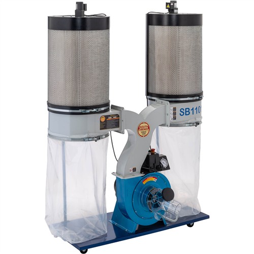

SB1101 3 HP Double Canister Dust Collector
An ultra-high-end, mid-sized dust collector for serious woodworkers.
The South Bend SB1101 3 HP Double Canister Dust Collector is the perfect mid-sized dust collector for serious hobbyists and professionals alike.
It can be connected to up to three machines running simultaneously—either as a stationary unit, or with its locking swivel casters, easily moved around as a point-of-use machine.
Machines manufactured beginning in 2022 feature a heavy-gauge clear plastic adapter that allows three 4" lines to be connected simultaneously. This allows for easy visibility and will help track down potential clogs.
Its 3 HP motor, 67-gallon collection capacity, and high-end features not found on typical dust collectors sold by other brands will help keep the air and surfaces in your shop dust free.
South Bend dust collectors feature automatic motorized filter brushes that clean the internal dust from the canister filter pleats at regular intervals.
A built-in vacuum gauge that tells you when it’s time to replace the filter and a remote-controlled magnetic switch that allows you to power up and shut down the collector from anywhere in your shop.
The SB1101 comes with a 2-year warranty and is built to South Bend high-precision industrial standards.
The SB1101 manual was written by our U.S.-based Technical Documentation Department and is packed with useful information.
The South Bend Customer Service and Technical Support Teams are U.S.-based. Parts may be available online and shipped from the South Bend parts warehouse in Springfield, MO.
