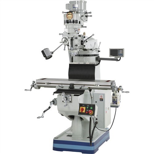

SB1025F 9" x 42" 2 HP 3-Phase Mill with DRO
All the precision you could ever need, masterfully executed in this South Bend milling machine.
The SB1025F 9" x 42" 2 HP 3-Phase Mill with a 3-axis Fagor DRO is easy to set-up truly accurate, and built to give you long years of service when properly cared for.
These milling machines feature 3-axis table movement with built-in longitudinal power feed and support workpieces up to 750 pounds.
To ensure quality results, the mill is equipped with premium angular contact spindle bearings that are rated to P4 tolerances. The spindle taper is R-8 and the spindles have powered down feed with fine, medium, and coarse feed controls.
The machine uses a 2HP induction motor and provides variable spindle speed from 80–5600 RPM.
The head is mounted on a wide dovetail-way ram with 13" of travel and 360° rotating capability. The head itself can swivel 90° left/right or 45° forward/back so it can be positioned for nearly any setup needed.
To reduce the time spent doing daily lubrication, this milling machine is outfitted with an one-shot lubrication system that is as quick and easy as one pump of a lever.

  • Spindle motor: 2 HP, 3-phase, 220V, 6A
  • Spindle travel: 5"
  • Spindle taper: R-8
  • Spindle speeds: 80–5600 RPM (variable; 16 steps)
  • Spindle nose to table: 0"–18"
  • Spindle centerline to column surface: 6"–19"
  • Longitudinal travel: 24-1/2" with power feed, 29-1/2" without power feed
  • Cross travel: 13"
  • Vertical (knee) travel: 16"
  • Table size: 9" x 42"
  • Table T-slots: (3) 5/8"
  • Maximum workpiece weight: 750 lbs.
  • Automatic vertical feeds (per revolution): 0.0015", 0.003", 0.006"
  • Head swivel: (L/R) 90°, (F/R) 45°
  • Ram travel (In/Out): 13"
  • Ram swivel: 180°
  • Overall dimensions: 63" W x 58" D x 81" H
  • Approximate shipping weight: 2140 lbs.
  • Fagor 3-axis DRO
  • Meehanite® casting
  • Allen-Bradley® controls
  • Turcite®-B Slydway®
  • Japanese NSK/NTN bearings
  • Table, knee and ram are equipped with dual locking mechanisms
  • Longitudinal table power feed with rapid override
  • One-shot lubrication
  • Work light
