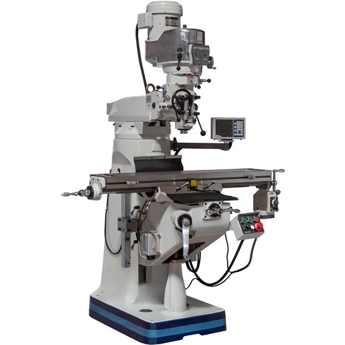

SB1124F 3 HP Variable-Speed Turret Mill With DRO
Featuring the traditional Bridgeport head design, this premier turret mill is the machine of choice for your production industrial shop.
If versatility and precision are equally important for your metalworking operations, you need a knee mill with a Bridgeport head.
The Bridgeport head is adaptable for various milling functions, whether you are cutting intricate designs, boring precise holes, tapping threads, or completing other specialized tasks.
The SB1124F offers exceptional cutting accuracy no matter the metalworking process, and features P-4 (ABEC-7) high-quality angular contact spindle bearings and a chromed steel quill.
This high-end mill also includes an electronic variable-speed function for limitless adjustment of the spindle speed based on the material and cutting operation.
As a user-friendly knee mill, this premium machine is designed for repeatable, accurate cuts, and is built to withstand heavy use.
To boost the accuracy of this dynamic machine, the Fagor DRO gives you exact measurement, down to 0.0002". No more manual measurement. Reduce the possibility of human error!
The SB1124F also features a large-scale 9" x 48" table with a 400-pound capacity. This offers plenty of space for creating precision tooling or developing customized prototypes.
Additional features of this multi-functional turret mill include auto-downfeed with micro-adjustable stop, precision-ground table surface, and a powered recycling coolant system.
- Spindle motor: 3 HP, 220V/440V* (prewired 220V), 3-phase, 8A/4A
- Spindle travel: 4-15/16"
- Spindle taper: R-8
- Spindle speed: Variable, 60–4200 RPM
- Max. spindle to column: 19"
- Max. spindle to table: 18-1/4"
- Longitudinal travel: 30-1/4"
- Cross travel: 11-1/4"
- Vertical travel: 15"
- Ram travel: 12"
- Turret swivel: 360°
- Head tilt: (L/R) 90°, (F/R) 45°
- Table size: 9" x 48"
- Table T-Slots: (3) 5/8"
- Quill feed rates: 0.0015", 0.003", 0.006"/rev.
- Footprint: 24" x 36"
- Overall dimensions: 64" W x 57" D x 84" H
- Approximate shipping weight: 2625 lbs.
- Fagor 3-Axis DRO
- Meehanite® casting
- High-quality, low-vibration TEFC spindle motor
- Auto-downfeed stop with micro-adjustable stop
- Variable-speed longitudinal power feed
- Precision-ground table surface
- Chromed steel quill
- Heavy-duty spindle brake
- Japanese Nachi bearings
- Table, knee, and ram are equipped with dual locking mechanisms
- Lever-action, one-shot pump lubrication system
- Powered recycling coolant system
- 2-Year limited warranty
