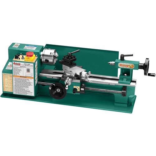

Image for Grizzly G8688 - 7" x 12" Mini Metal Lathe

G8688 7" x 12" Variable-Speed Benchtop Metal Lathe
A great starter lathe offered at an incredibly low price!
Compact yet capable, this mini lathe is perfect for hobbyists, tinkering, and small parts–ideal for model makers and home machinists.
Powered by a 1/3 HP motor, it cuts right-handed and left-handed threads while easily fitting on your bench so you can machine your own parts.
The G8688 is equipped with features found on larger lathes including inch and metric dials, a turret tool post, and 3" three-jaw chuck with external jaws.
The variable-speed spindle control allows you to quickly set the spindle speed within the available range of 0–2500 RPM.
The chip tray and splash guard on the spindle keeps debris contained.
