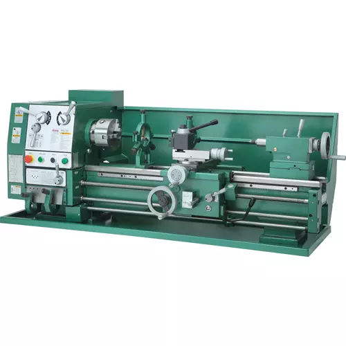

G4003 12" x 36" Gearhead Lathe
Exceptional value in a full-sized lathe!
The gearhead spindle of the G4003 12" x 36" Lathe lets you select speeds without having to fuss with belts or pulleys.
Shifting gears is as easy as switching a couple of front-mounted levers, so you can complete projects with minimal downtime.
The G4003 has nine spindle speeds from 70–1400 RPM, so you can adjust the speed as needed to keep your projects on course.
The quick-change gearbox makes thread cutting selection fast and efficient.
The optional T10556 Taper Attachment, G4026 Collet Attachment, and G4005 Lathe Stand are all great accessories to help you get the most out of your lathe.
The power and features you need in a gearhead lathe.
Like all Grizzly lathes, the G4003 comes with a 1-year warranty covering parts and assuring the unit is free from factory defects.
The G4003 manual was written by our U.S.-based Documentation Department and is packed with useful information. The complete and easy-to-read manual makes it easier to assemble and maintain your lathe.
The Grizzly Technical Support team is U.S.-based. Parts for the lathe may be available online and shipped from the Grizzly parts warehouse in Springfield, MO.
  • Motor: 2 HP, 220V, single-phase, 8.5A
  • Swing over bed: 12"
  • Swing over cross slide: 7"
  • Distance between centers: 36"
  • Bed width: 7-1/4"
  • Spindle bore: 1.417" (36mm)
  • Spindle nose taper: MT#5
  • Spindle nose: D1-4 Camlock
  • Spindle speeds: 9, 70–1400 RPM
  • Compound travel: 3-1/4"
  • Cross slide travel: 6-1/4"
  • Tailstock barrel taper: MT#3
  • Tailstock barrel travel: 4"
  • Overall dimensions: 61" W x 23" D x 23" H
  • Approx. shipping weight: 1020 lbs.
  • Spindle on/off reverse switch on carriage
  • Easy-to-use lever controls
  • Full-length splash guard
  • Hardened and ground cast-iron bed
  • Threading dial
STANDARD EQUIPMENT:
  • 6" 3-Jaw chuck w/2 sets of jaws
  • 8" 4-Jaw chuck w/reversible jaws
  • 10" Faceplate
  • Steady rest
  • Follow rest
  • 4-Pc. Insert Tool Holder Set
  • Quick-change tool post with one tool holder
  • Two MT#3 dead centers (1 carbide-tipped)
  • MT#3 live center
  • Set of seven change gears
  • 1/2" Chuck with MT#3 arbor
  • Toolbox
Headstock oil not included.
