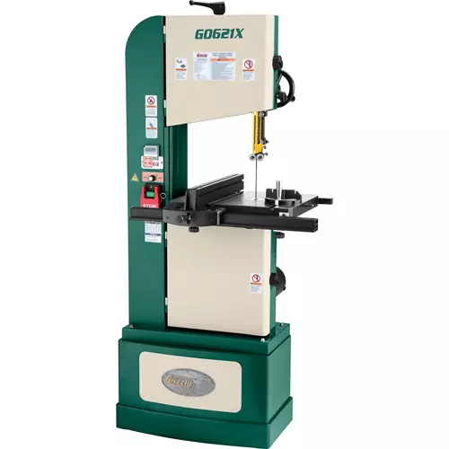

G0621X 13-1/2" 1-1/4 HP Vertical Wood/Metal Bandsaw
Affordable versatility not found on any saw in its class.
The G0621X 13-1/2" 1-1/4 HP Vertical Wood/Metal Bandsaw has the rugged functionality of two machines in one.
This bandsaw features a variable-speed drive which allows you to slow the blade down for cutting metal and speed the blade up for cutting wood.
Adjusting the speed of the blade is as simple as turning a dial. The speed is displayed in FPM on a digital display.
Blade changes are fast and easy with the quick-release blade feature. For a full range replacement and resaw blades for the G0621X, shop here.
The precision-ground cast-iron table tilts 45° right and 5° to the left.
The three ball-bearing rollers on the upper and lower blade guide assemblies are easy to adjust.
