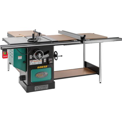

G0652 10" 5 HP 3-Phase Heavy-Duty Cabinet Table Saw
Outfeed tables make cutting long panels and wide stock much easier.
The G0652 10" 5 HP 3-Phase Heavy-Duty Cabinet Table Saw makes large-scale production ripping operations possible by combining the 52" rip capacity with the precision-ground cast-iron extended side and rear tables that support a full sheet of plywood.
The underside of the 10" blade is encapsulated with a dust hood for improved dust collection and reduced need for cleaning inside the cabinet.
The aluminum fence faces and scale indicators read on both sides of the fence, allowing easy fence use on either side of the blade.
A digital readout for the blade angle allows you to set and cut precise bevels every time with consistent results.
CSA certified
*This machine is prewired for 220V. We can rewire to 440V in a few days’ time for a fee. Please contact Grizzly Technical Support at (570) 546-9663 before placing your order.
  • Required power source: 220V or 440V, 3-phase, min. 15A circuit
  • Motor: 5 HP, 220V/440V* (prewired for 220V), 3-phase, 12A/6A
  • Rip capacity: 52" right, 18" left of blade
  • Max. depth of cut @ 90°: 3-3/16"
  • Max. depth of cut @ 45°: 2-3/16"
  • Overall table dimensions: 75-3/4" W x 65-3/4" D
  • Distance from front of table to center of blade: 14-7/8"
  • Floor-to-table height: 34-7/8"
  • Arbor diameter: 5/8"
  • Arbor speed: 4000 RPM
  • Max. width of dado: 3/4"
  • Dust port size: 4"
  • Overall dimensions: 91-1/2" W x 75" D x 40-5/8" H
  • Approximate shipping weight: 774 lbs.
  • Digital readout for bevel angle
  • Right and rear extension tables
  • Cast-iron trunnions
  • 3/8" x 3/4" T-slots & heavy-duty miter gauge
  • Poly-V serpentine drive belt
  • Large rail-mounted switch
  • 10" x 40T blade
