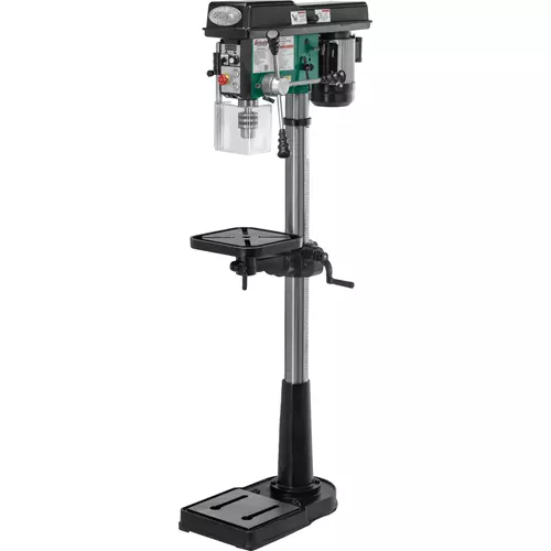

T34613 15" Floor Variable-Speed Drill Press
Get consistent drilling results with the flexibility of variable speed.
This drill press offers smooth and controlled variable speed powered by a variable frequency drive (VFD) for the ultimate in precision drilling.
Laser line guides and an LED light help prevent drilling errors for consistent results on your DIY, hobby, and custom projects.
A dial-style spindle depth stop allows you to set the depth for consistent repeat drilling operations.
The professional-level chuck guard is durable and simple to modify, and a chuck key holder prevents accidental key loss.
The cast-iron table offers essential stability for consistent, high-quality drilling results without excessive wear to the machine.
FEATURES & BENEFITS:
  • Two Variable-Speed Spindle Speed Ranges: Optimal power and control for every project, ensuring smoother drilling results.
  • Spindle Speed Dial: Easily control variable belt speed with a user-friendly dial and digital readout.
  • Variable-Frequency Drive: Uses a VFD for smooth, high-torque variable speed using single-phase power.
  • Laser Line Guides: Adjustable Class II guides ensure precision drilling to avoid mistakes and material waste.
  • LED Light: Increases visibility for better results and improved safety.
  • Depth Stop: Provides simple adjustments and ensures consistent drilling depth with the turn of a dial.
  • Chuck Guard w/Safety Switch: Adds another layer of protection from drilling debris.
  • Chuck Key Holder: Avoid misplacing your chuck key and keep it within reach.
  • Precision-Ground Cast-Iron Table: Durable construction to withstand extensive use.
  • Required power source: 110V, single-phase, min. 15A circuit
  • Motor: 1 HP, 1.85A
  • Swing: 15-1/4"
  • Spindle taper: MT#2
  • Spindle travel: 3-1/4"
  • Spindle speeds: Variable; 30-650, 130-3000 RPM
  • Drill chuck: JT3 keyed, 5/8"
  • Drilling capacity: 5/8" Mild steel
  • Maximum distance from spindle to table: 28-3/8"
  • Table dimensions: 10-9/16" x 10-9/16"
  • Table tilt: 0-45° L/R
  • Table swivel around column: 360°
  • T-slots (x4): 9/16"
  • Footprint: 20-1/2" x 12-1/2"
  • Overall dimensions: 15" W x 27-1/2" D x 63" H
  • Approximate shipping weight: 153 lbs.
