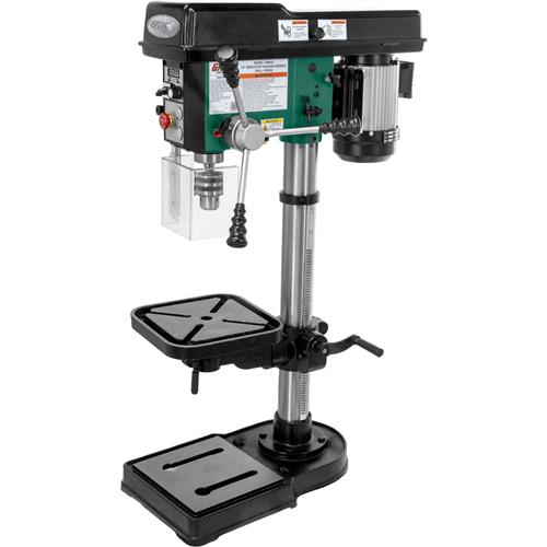

Image for Grizzly T34612 - 15" Benchtop Variable-Speed Drill Press
$940.00 Price: $940.00
T34612 15" Benchtop Variable-Speed Drill Press
The convenience of benchtop drilling with the versatility of variable speed.
This compact drill press offers smooth and controlled variable speed powered by a variable frequency drive (VFD) for the ultimate in precision drilling.
Laser line guides and an LED light help prevent drilling errors for consistent results on your DIY, hobby, and custom projects.
A dial-style spindle depth stop allows you to set the depth for consistent repeat drilling operations.
It features a durable chuck guard for safety and a convenient chuck key holder to keep track of your chuck key.
The cast-iron table offers essential stability for consistent, high-quality drilling results without excessive wear to the machine.
FEATURES & BENEFITS:
  • Two Variable-Speed Spindle Speed Ranges: Optimal power and control for every project, ensuring smoother drilling results.
  • Spindle Speed Dial: Easily control variable belt speed with a user-friendly dial and digital readout.
  • Variable-Frequency Drive: A VFD offers smooth, high-torque variable speed using single-phase power.
  • Laser Line Guides: Adjustable Class II guides ensure precision drilling to avoid mistakes and material waste.
  • LED Light: Increases visibility for better results and improved safety.
  • Depth Stop: Provides simple adjustments and ensures consistent drilling depth with the turn of a dial.
  • Chuck Guard w/Safety Switch: Adds another layer of protection from drilling debris.
  • Chuck Key Holder: Avoid misplacing your chuck key and keep it within reach.
  • Precision-Ground Cast-Iron Table: Durable construction to withstand extensive use.
  • Required power source: 110V, single-phase, min. 15A circuit
  • Motor: 1 HP, 1.85A
  • Swing: 15-1/4"
  • Spindle taper: MT#2
  • Spindle travel: 3-1/4"
  • Spindle speeds: Variable; 30-650, 130-3000 RPM
  • Drill chuck: JT3 keyed, 5/8"
  • Drilling capacity: 5/8" Mild steel
  • Maximum distance from spindle to table: 18-1/16"
  • Table dimensions: 10-9/16" x 10-9/16"
  • Table tilt: 0-45° L/R
  • Table swivel around column: 360°
  • T-slots (x4): 9/16"
  • Footprint: 20-1/2" x 12-1/2"
  • Overall dimensions: 15" W x 26" D x 42" H
  • Approximate shipping weight: 142 lbs.
Experience precision drilling at your fingertips—adaptable speed in a benchtop design.
