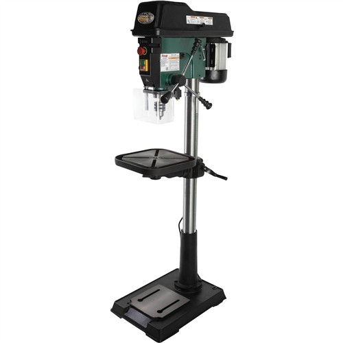

  • Motor: 1-1/4 HP
  • Power Requirement: 120V, Single-Phase, 60 Hz
  • Swing: 17 in.
  • Type: Floor
  • Range of Spindle Speeds: 200 - 720, 700 - 2200 RPM
  • Drilling Capacity: 5/8 in.
  • Drill Chuck Type: JT3 Keyed
  • Quill Diameter: 2.01 in.
  • Shipping weight: 232 lbs.
T33961 17" Variable-Speed Floor Drill Press
Perform precision drilling with this efficient variable-speed floor drill press.
The T33961 Floor Drill Press is the perfect choice if you need a well-equipped machine to enhance your drilling processes.
The Reeves drive allows for variable-speed adjustments between 700 and 2200 RPM with a simple lever movement instead of moving belts on pulleys. For low RPM drilling through dense materials, you slip the belt an additional pulley for speeds between 200 and 720 RPM.
Keep a close eye on your spindle speed and adjust it as often as needed with the easy-to-read DRO.
The Class II laser gives the precision required for every project by preventing alignment mistakes – no guesswork involved.
A built-in LED work light below the headstock of this variable-speed drill press provides helpful extra illumination.
Rack-and-pinion table elevation control allows for effortless, precise adjustments based on your material thickness.
The square chuck safety guard comes with a micro switch that shuts the drill press off if the guard is opened.
This floor variable-speed drill press also includes four 5/8" T-slots and a clear chip guard for protection from debris.
The heavy-duty mill-style depth stop is highly dependable and won't slip, ensuring precise drilling. Once it makes contact, your drilling depth is securely set.
The go-to drill press for professionals and enthusiasts alike.
The T33961 manual was written by our U.S.-based Technical Documentation Department and is packed with useful information. The complete and easy-to-read manual makes it easier to assemble and maintain your drill press.
  • Motor: 1-1/4 HP, 120V, single-phase, 11.9A
  • Swing: 17"
  • Spindle taper: MT#2
  • Spindle speed: Variable, 200-720, 700-2200 RPM
  • Drill chuck: 5/8", JT3 keyed
  • Drilling capacity: 5/8" steel
  • Table size: 14" x 14"
  • Table tilt: 45° left/right
  • Table swivel around column: 360°
  • T-slots: (x4) 5/8", 2-3/8" on center
  • Footprint: 23" x 16-1/2"
  • Overall dimensions: 17" W x 30" D x 67" H
  • Approximate shipping weight: 232 lbs.
  • Adjustable Class II laser guide
  • Spindle speed digital readout
  • Rack-and-pinion table elevation control
  • Built-in LED work light
  • Square chuck guard with micro switch
  • Clear chip guard
  • Four 5/8" T-slots
  • Mill-style depth stop
