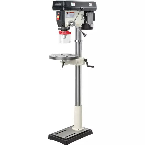

W1680 17" Floor Drill Press
A best in class drill press for long-lasting performance and reliability.
The Shop Fox W1680 17" Floor Drill Press is perfect for the average size cabinet shop or small machine shop.
The W1680 is fitted with a 1/16" to 5/8" JT-3 keyed drill chuck and a Morse Taper #3 for the larger direct mount bits.
This 17" Floor Drill Press offers 3-1/4" of spindle travel and a drilling capacity of 1" through mild steel.
The 14" diameter, round table can swivel 360° around the column and allows for drilling at different angles as it tilts 90° in both directions.
Setting the adjustable depth stop allows for predetermined and repeatable drilling.
With solid cast-iron construction, sealed ball bearings, and rubber coated quick-adjust handles, the W1680 has the quality and convenience you want in a machine investment.
There is even a built-in light so you can see what your workpiece.
The W1680 manual was written by our U.S. based Technical Documentation Department and is packed with useful information. The complete and easy-to-read manual makes it easier to assemble and maintain your drill press.
Made in an ISO 9001 Factory
  • Motor: 1 HP, 110V, single-phase, 10A
  • Swing: 17"
  • Spindle taper: MT3
  • Spindle travel: 3-1/4"
  • Spindle speed: 12, 140–3050 RPM
  • Drill chuck: 1/16"-5/8", JT-3
  • Drilling capacity: 1" mild steel
  • Maximum distance from spindle to table: 31-1/2"
  • Head swivel: 360°
  • Table: Round, 14" diameter
  • Table tilt: 90° left/right
  • Table swing: 360°
  • Table T-slots: 6 @ 5/8"
  • Footprint: 11" x 22-1/2"
  • Overall dimensions: 15" W x 27-1/2" D x 66" H
  • Approximate shipping weight: 235 lbs.
  • Two-year warranty!!
  • Low RPM for metal working
  • Threaded depth stop
  • Crank handle operated rack-and-pinion vertical table movement
  • Includes built-in light
  • Table and base are cast-iron
  • 1 HP motor
  • 12 Speeds
  • 3-1/4" spindle travel
  • Cushioned grip quill handles
  • 1/16"-5/8" Drill chuck
