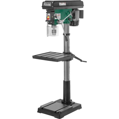

T34611 20" Floor Drill Press w/ LED Light & Laser
A multifunctional drill press with a large swing for handling oversized workpieces.
Whether you are a beginner or an experienced user, this 20" drill press is equipped to easily complete counterboring, tapping, reaming, and other essential drilling process.
Laser line guides and an LED light help prevent drilling errors and ensure consistency for your DIY, hobby, and custom projects.
A push-button spindle depth stop allows you to set the depth for consistent repeat drilling operations.
It features a durable chuck guard for safety and a convenient chuck key holder to keep track of your chuck key.
The cast-iron table offers essential stability for consistent, high-quality drilling results without excessive wear to the machine.

  • Precision-Ground Cast-Iron Table: Durable construction with rack-and-pinion elevation control for smooth, precise, and effortless height adjustments.
  • Motor: 2 HP, 120V, single-phase, 12.9A
  • Swing: 20-1/4"
  • Spindle taper: MT#3
  • Spindle travel: 4-3/4"
  • Spindle speeds: 12, 180-3550 RPM
  • Drill chuck: JT3 keyed, 5-20mm
  • Drilling capacity: 1-1/8" Mild steel
  • Maximum distance from spindle to table: 25-5/8"
  • Table dimensions: 16-3/4" x 18-3/4"
  • Table tilt: 0-45° L/R
  • Table swivel around column: 360°
  • T-slots (x3): 15mm
  • Footprint: 23" x 18"
  • Overall dimensions: 23" W x 34" D x 66-1/2" H
  • Approximate shipping weight: 254 lbs.
