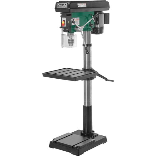

T34611 20" Floor Drill Press w/ LED Light & Laser
A multifunctional drill press with a large swing for handling oversized workpieces.
Whether you are a beginner or an experienced user, this 20" drill press is equipped to easily complete counterboring, tapping, reaming, and other essential drilling process.
Laser line guides and an LED light help prevent drilling errors and ensure consistency for your DIY, hobby, and custom projects.
A push-button spindle depth stop allows you to set the depth for consistent repeat drilling operations.
It features a durable chuck guard for safety and a convenient chuck key holder to keep track of your chuck key.
The cast-iron table offers essential stability for consistent, high-quality drilling results without excessive wear to the machine.
FEATURES & BENEFITS:
  • Laser Line Guides: Adjustable Class II guides ensure precision drilling to avoid mistakes and material waste.
  • LED Light: Increases visibility for better results and improved safety.
  • Depth Stop: Provides simple adjustments and ensures consistent drilling depth.
  • Chuck Guard: Adds another layer of protection from drilling debris.
  • Chuck Key Holder: Avoid misplacing your chuck key and keep it within reach.
  • Precision-Ground Cast-Iron Table: Durable construction with rack-and-pinion elevation control for smooth, precise, and effortless height adjustments.
  • Motor: 2 HP, 120V, single-phase, 12.9A
  • Swing: 20-1/4"
  • Spindle taper: MT#3
  • Spindle travel: 4-3/4"
  • Spindle speeds: 12, 180-3550 RPM
  • Drill chuck: JT3 keyed, 5-20mm
  • Drilling capacity: 1-1/8" Mild steel
  • Maximum distance from spindle to table: 25-5/8"
  • Table dimensions: 16-3/4" x 18-3/4"
  • Table tilt: 0-45° L/R
  • Table swivel around column: 360°
  • T-slots (x3): 15mm
  • Footprint: 23" x 18"
  • Overall dimensions: 23" W x 34" D x 66-1/2" H
  • Approximate shipping weight: 254 lbs.
Get a drill press that's perfectly sized for a small shop, with features that advanced users will appreciate.
Grizzly owner's manuals and instruction sheets are produced by our U.S.-based Technical Documentation Department and are packed with useful information. Parts may be available online and are shipped from the Grizzly parts warehouse in Springfield, MO.
Need help? We offer U.S.-based customer service and technical support to get your questions answered and help keep your equipment running in top condition. And to ensure your satisfaction, the T34608 comes with a 1-year warranty.
