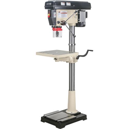

Shop Fox M1039 20" Floor Drill Press
A workhorse drill press for most woodworking and metalworking applications.
The professional-grade Shop Fox M1039 20" Floor Drill Press is one of the most versatile and handy machines you can add to your shop.
Woodworkers and metalworkers alike enjoy the huge 18-3/4" x 16-3/4" table, speeds from 180–3240 RPM, built-in 110V work light over the table, and a generous 4-3/4" spindle travel.
The table features T-slots and coolant channels—which allows it to be easily outfitted with a vise or clamps—and helps contain cutting fluids when drilling metal.
It can swivel 360° around the column and allows for drilling at different angles as it tilts 90° in both directions.
The M1039 boasts a powerful 1-1/2 HP motor that smoothly powers the twelve spindle speeds ranging from 180–3240 RPM.
This 20" Floor Drill Press has a drilling capacity of 1" through mild steel. The low RPM speed is vital to drilling metal.
Setting the adjustable depth stop allows for predetermined and repeatable drilling.
Prewired for 120V, the M1039 can plug into a standard 120V wall receptacle or can be converted to operate on a 240V power supply. If you prefer 240V, refer to the Voltage Conversion instructions in the manual.
Like all Shop Fox drill presses, the M1039 comes with a 2-year warranty which covers parts and assures the unit is free from factory defects. (Consumables are not covered by the warranty.)
The M1039 manual was written by our U.S.-based Technical Documentation Department and is packed with useful information. The complete and easy-to-read manual makes it easier to assemble and maintain your drill press.
The Shop Fox Customer Service and Technical Support Teams are U.S.-based. Parts for the drill press may be available online and shipped from the parts warehouse in Springfield, MO.
Made in an ISO 9001 Factory
ETL certified
  • Motor: 1-1/2 HP, 120V/240V (prewired for 120V), single-phase, 18A/9.4A
  • Swing: 20"
  • Drill chuck: 5/8"
  • Drilling capacity: 1-1/4" mild steel
  • Arbor: JT-3
  • Spindle speed: 12, 180–3240 RPM
  • Spindle travel: 4-3/4"
  • Table size: 16-3/4" W x 18-3/4" L
  • Table swing: 360 degrees
  • Table tilt: 90° left/right
  • Footprint: 18" W x 23" L
  • Overall dimensions: 21" W x 34-3/4" L x 70-3/4" H
  • Approximate shipping weight: 317 lbs.
  • Two-year warranty!!
  • Features table T-slots and coolant channel
  • Crank handle operated rack-and-pinion vertical table movement
  • 12 Speeds
  • Threaded depth stop
  • Built-in light (120V Only)
  • 4-3/4 in. Spindle travel
