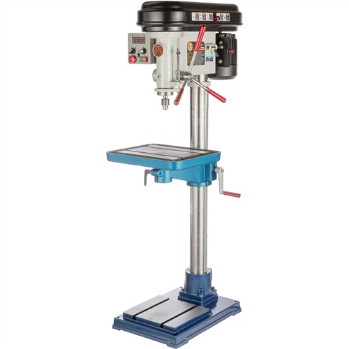

SB1125 19-1/2" Variable-Speed Drill Press
A high-performance drill press with a powerful motor and variable-speed control.
This smooth-running South Bend SB1125 19-1/2" Floor Drill Press features a two-range variable spindle speed control ranges between 50 to 2000 RPM, monitored via a digital readout. This wide range of speeds makes it perfect for both woodworkers as well as metalworkers.
The torque created by the 1 horsepower motor combined with the low spindle speeds allows for an impressive 1-9/16" capacity for drilling mild steel.
The 16" by 20" precision-ground cast-iron table has two 5/8" T-slots, with 360° table positioning around column, and hand-crank enabled rack-and-pinion table elevation. The table can be swung to the back when drilling tall work pieces; securing it to the cast-iron base using the two 5/8" T-slots.
The SB1125 features a full 5-1/2" of spindle travel with, MT#3 spindle, and comes with a 5/8" capacity drill chuck.
The complete and easy-to-read SB1125 manual was written by our U.S.-based Technical Documentation Department and is packed with useful information.
  • Required power source: 220V, single-phase, min. 15A circuit
  • Motor: 1 HP, 220V
  • Swing: 19-1/2"
  • Spindle speed: Variable, 50–400, 300–2000 RPM
  • Spindle travel: 5-1/2"
  • Spindle taper: MT#3
  • Maximum distance spindle to table: 31-1/2"
  • Drilling capacity: 1-9/16" mild steel
  • Table size: 16" x 20"
  • Table swivel: 30° R/L
  • Table T-slots: 2 @ 5/8"
  • Drill chuck type and size: JT6 key chuck, 3/64"–5/8"
  • Footprint: 17-1/2" x 25-1/2"
  • Overall dimensions: 21-1/2" W x 33" D x 68-1/2"
  • Approximate shipping weight: 514 lbs.
  • 2-year limited warranty
  • Variable-speed control from 50–400 and 300–2000 RPM
  • 360° Table positioning around column
  • Control panel with front-mounted E-stop button and forward/reverse switch
  • 16" x 20" Precision-ground cast-iron table
  • Rack-and-pinion table elevation
  • Digital speed display
  • Built-in LED light
