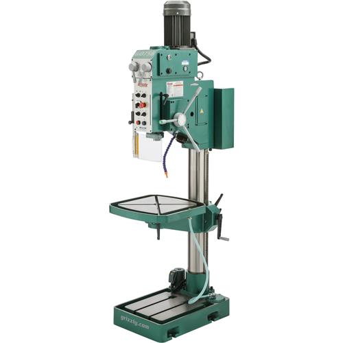

Grizzly G0756 - 27-1/2" Heavy-Duty Gearhead Drill Press
5.0 (1)
$6,625.00
  • Motor: 1-1/8 HP / 2 HP
  • Table size: 22 in. x 22 in.
  • Spindle taper: MT#4
  • Number of speeds: 18
  • Max spindle to table: 30-3/4 in.
  • Max spindle to column: 13-3/4 in.
  • Shipping weight: 1202 lbs.
G0756 27-1/2" Heavy-Duty Gearhead Drill Press
Built for the most demanding production shops, the Grizzly G0756 27-1/2" Heavy-Duty Gearhead Drill Press delivers the precision, power, and speed you need to tackle any job. This machine is engineered for professionals who require a rock-solid, high-performance drill press capable of handling large-scale projects and materials.
Why a Gearhead Drill Press?
Unlike belt-driven machines, gearhead drill presses are designed for drilling larger holes with less effort. The G0756 features a 1-1/8 HP / 2 HP motor that provides the brute force needed for heavy-duty drilling and tapping. You'll experience superior torque and consistent power, even when working with tough metals.
FEATURES and BENEFITS:
  • Quick-Change Gearbox Controls: Say goodbye to the hassle of changing belts. The convenient gearbox controls let you quickly change spindle speeds by simply twisting a lever or two. With 18 speeds from 60–1740 RPM, you can instantly find the perfect setting for any material or bit size, saving you valuable time and effort.
  • Massive, Rigid Construction: A huge 6" column diameter provides the necessary stability to ensure repeatable accuracy, even when drilling large 1-1/2" holes at high speeds. The precision-ground cast-iron table is nearly 2" thick and features a 22" x 22" work surface, giving you ample support for large workpieces.
  • 7" Spindle Travel with Power Downfeed: The MT #4 spindle offers an impressive 7" of travel, along with a 2-speed automatic downfeed for consistent, controlled drilling. You also get a power tapping with an electronic clutch, making thread cutting faster and more precise than ever.
  • Enhanced Workflow: The built-in LED work light illuminates your workspace, ensuring a clear view of your work. The tooling ejection feature makes bit changes fast and easy, while the built-in coolant system is a vital feature for extending tool life and ensuring a cleaner cut when drilling metal.
  • Main motor: 1-1/8 / 2 HP, 220V, 3-phase, 6.4A
  • Coolant pump: 75W
  • Swing: 27-1/2"
  • Max. spindle to table: 30-3/4"
  • Max. distance spindle to column: 11"
  • Spindle travel: 7"
  • Spindle speeds: 18, 60–740 RPM
  • Spindle taper: MT #4
  • Drilling capacity for cast-iron: 1-1/2"
  • Drilling capacity for steel: 1"
  • Downfeed speeds: 1mm/rev, 2mm/rev
  • Table size: 22" L x 22" W x 1-7/8" H
  • Vertical table travel: 20"
  • Table swivel: 360°
  • Table T-slot size: 9/16"
  • Quill diameter: 3"
  • Footprint: 29" x 20"
  • Overall size: 22" W x 37" D x 89-1/2" H
  • Approximate shipping weight: 1202 lbs.
