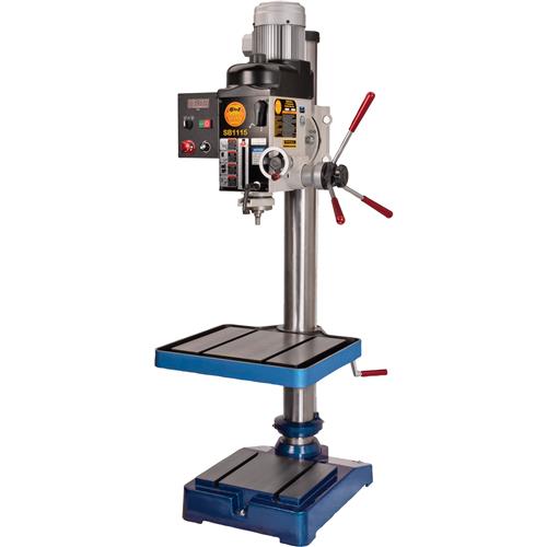

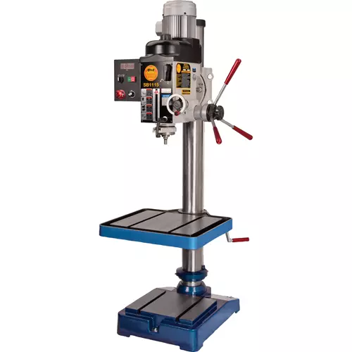

SB1115 21" Variable-Speed Gearhead Drill Press
Unbeatable raw-drive power, performance, and precision.
This powerful, professional-level South Bend gearhead drill press features all the precision and high-end capability you need to put out your best work.
Geared drill presses are designed for drilling larger holes than belt driven machines thanks to the spindle bearings and tighter tolerances.
The spindle is fully reversible, features both coarse and fine downfeed controls, and a depth stop for repeatable production.
The variable speed range between 0 and 2500 RPM is controlled by spindle speed dial and a high/low spindle speed lever. Low RPM speed is vital to drilling metal.
Additional features, such as a digital spindle speed readout on the headstock and a clutch-engaged downfeed function make this gearhead drill press top of its class in design and functionality.
  • Required power source: 220V, single-phase, min. 15A circuit
  • Spindle motor: 1-1/2 HP, 220V
  • Spindle taper: MT#3
  • Spindle speed: Variable, 0–350 RPM (Low) and 0–2500 RPM (High)
  • Spindle travel: 5"
  • Maximum distance spindle to column: 10-7/16"
  • Maximum distance spindle to table: 17-3/8"
  • Cross travel: 7"
  • Drilling capacity: 1-1/2" steel and cast iron
  • Head travel: 13-3/8"
  • Head tilt: 30° Right / 90° Left
  • Table size: 21-3/4" W x 19-1/2" D x 2-1/4" T
  • Table T-slots: 2 @ 1/2"
  • Drill chuck type and size: JT6 key chuck, 1/64"–5/8"
  • Footprint: 26" x 18-1/2"
  • Overall dimensions: 42" W x 35" D x 69" H
  • Approximate shipping weight: 683 lbs.
  • Powered or hand crank-enabled rack-and-pinion table elevation
  • Coarse and fine downfeed controls
  • Red anodized spindle stroke and table elevation handles
  • Cast-iron base with two 1/2" T-slots, 8-7/8" on center
  • 360° table and head positioning around column
  • Digital speed display
  • Front-mounted emergency stop button
  • Forward/reverse spindle switch
