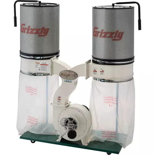

G0562ZP 3 HP Double Canister Dust Collector w/ Aluminum Impeller
Want the ultimate dust collector in your shop? Then this powerful machine is just what you need.
This dust collector is exactly the same as our popular G0562Z, but in our dazzling white Polar Bear Series color scheme.
Simply move the convenient top mounted lever back and forth to remove any dust caked onto the filter, and in seconds you are back to full performance capacity.
The steel duct from the impeller to the filter improves performance and reliability and with just a glance you'll know when it's time to haul out the chips thanks to clear bottom bags.
Extra bags ship with the machine and are available from us to really make cleaning easy.

  • Motor: 3 HP, 240V, single-phase, 12A
  • Blower/impeller: 12-3/4" balanced cast aluminum
  • Airflow capacity: 2320 CFM
  • Max. static pressure: 16.9"
  • Filtration: 1-Micron
  • Sound rating: 87dB
  • 7" inlet has removable "Y" fitting with three 4" inlets
  • Canister filter size (dia. x depth): 19-5/8" x 23-5/8" (2)
  • Bag capacity: 9 cubic feet
  • Footprint: 49-1/2" x 21-1/2"
  • Overall dimensions: 57-7/8" long x 32" wide x 71" high
  • Approximate shipping weight: 214 lbs.
  • With the canister filter, simply turn the handle on the top a half turn in either direction to clean the canister
  • The handle controls three cleaning flappers inside and shakes the dust from the filter letting the fine dust fall directly into the collection bag
  • The canister filter is made of spun bond polyester with 1-micron filter capacity
  • Heavy-gauge clear plastic adapter for easy visibility
  • Clear plastic collection bag with quick clamp
