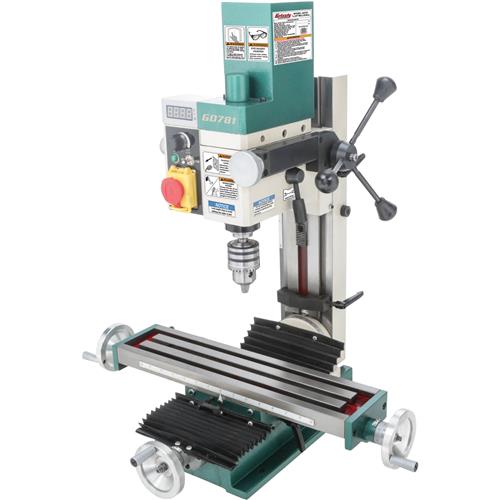

G0781 4" x 18" 3/4 HP Mill/Drill
An inexpensive, high-quality, and small bench top mill.
The combination of features on the G0781 4" x 18" 3/4 HP Mill/Drill makes quick work of whatever job is thrown at it.
This powerhouse comes equipped with a high-torque 3/4 HP motor, variable-speed controls, digital readout display, and fine downfeed control.
The head can be adjusted up and down the column and tilted 45° left or right relative to the table.
The high/low quick-change gearbox has variable speeds. The low range covers 50–1000 RPM, while the high range covers 100–2000 RPM.
The 4-1/4" x 18" table provides ample space for sizable projects and larger vises.
