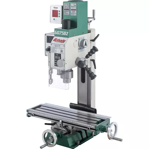

G0758Z 6" x 20" 3/4 HP Mill Drill with DRO
A highly precise and accurate mini mill drill with all the right features.
The G0758Z 6" x 20" 3/4 HP Mill Drill with DRO packs the most features of any Grizzly mill drill of this size. It is perfect for the DIY-er learning milling in their home shop or as a dedicated milling machine in a pro shop.
The variable-speed 3/4 HP motor powers the R-8 spindle from 50 to 2000 RPM. Spindle RPM can be monitored on the convenient digital readout. Spindle depth can be viewed on a separate digital readout with an inch/mm display and zeroing function.
The G0758Z also has super-rigid precision-ground dovetail headstock column and table ways, plus coarse and fine spindle downfeed. A clear chip guard on the spindle keeps debris from flying at the operator.
The G0758Z has a table that measures 5-3/4"W x 19-3/4"L that can be moved by precision handwheels in both the longitudinal and cross directions. Both feed directions can be locked by table lock levers.
With its R-8 spindle taper, it can also make use of a wide variety of tooling. When the going gets really tough, the headstock is equipped with a special shifter knob that allows you to drop power-transfer gearing down for maximum torque in the lowest RPM range.
Say hello to the champion of mini mills!

  • Motor: 3/4 HP, 110V, single-phase, 10A
  • Spindle taper: R-8
  • Spindle travel: 2"
  • Swing: 13-1/4"
  • Max. distance spindle-to-table: 8-3/4"
  • Head tilt: 45 degrees left & right
  • Head travel (Z-axis): 8-1/4"
  • Table travel (X-axis): 13-1/8"
  • Table travel (Y-axis): 4-1/2"
  • Table size: 5-3/4"W x 19-3/4"L
  • T-slots: 3 @ 1-1/2" centers, 3/8" wide
  • Spindle speed: Variable, 50-2000 RPM
  • Approximate shipping weight: 204 lbs.
  • Dovetail headstock column and table ways
  • High-torque, low-noise DC motor
  • Variable-speed spindle with DRO
  • Spindle elevation DRO
  • 3-Axis precision handwheel control
  • Coarse and fine spindle downfeed
  • 2-Speed gearbox
  • Zero-setting dials on handwheels
