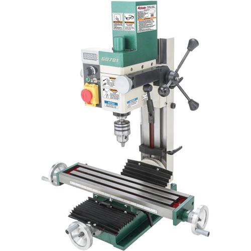

G0781 4" x 18" 3/4 HP Mill/Drill
An inexpensive, high-quality, and small bench top mill.
The combination of features on the G0781 4" x 18" 3/4 HP Mill/Drill makes quick work of whatever job is thrown at it.
This powerhouse comes equipped with a high-torque 3/4 HP motor, variable-speed controls, digital readout display, and fine downfeed control.
The head can be adjusted up and down the column and tilted 45° left or right relative to the table.
The high/low quick-change gearbox has variable speeds. The low range covers 50–1000 RPM, while the high range covers 100–2000 RPM.
The 4-1/4" x 18" table provides ample space for sizable projects and larger vises.
Like all the Grizzly Mills, the G0781 comes with a 1-year warranty covering parts and assuring the unit is free from factory defects. (Consumables are not covered by the warranty.)
The G0781 manual was written by our U.S.-based Technical Documentation Department and is packed with useful information. The complete and easy-to-read manual makes it easier to assemble and maintain your mill/drill.
The Grizzly Customer Service and Technical Support Teams are U.S.-based. Parts and accessories for the drill press may be available online and shipped from the Grizzly parts warehouse in Springfield, MO.
  • Motor: 3/4 HP, 110V, single-phase, 5A
  • Spindle taper: R-8
  • Spindle speeds: Variable, 50–1000 and 100–2000 RPM
  • Max distance spindle-to-column: 6-3/8"
  • Max distance spindle-to-table: 11-1/2"
  • Drilling capacity: 1/2" mild steel
  • End milling capacity: 1/2"
  • Face milling capacity: 1"
  • Head travel: 7-1/16"
  • Column tilt: 45° left/right
  • Table size: 4-1/4" x 18"
  • T-slots: 3 @ 1-1/4" centers, 7/16" wide
  • Table travel (longitudinal): 11-13/16"
  • Table travel (cross): 5-1/8"
  • Footprint: 14-1/2" x 8-1/2"
  • Overall size: 26-1/2" W x 20-1/2" D x 31" H
  • Approximate shipping weight: 167 lbs.
  • Fine downfeed control
  • High/low geared drive
  • Digital readout display
  • Adjustable depth stop
  • Rubber chip guards on ways
  • Precision-ground dovetail column
  • R-8 spindle
  • 3–16mm JT3 drill chuck
  • Safety shut-off button
