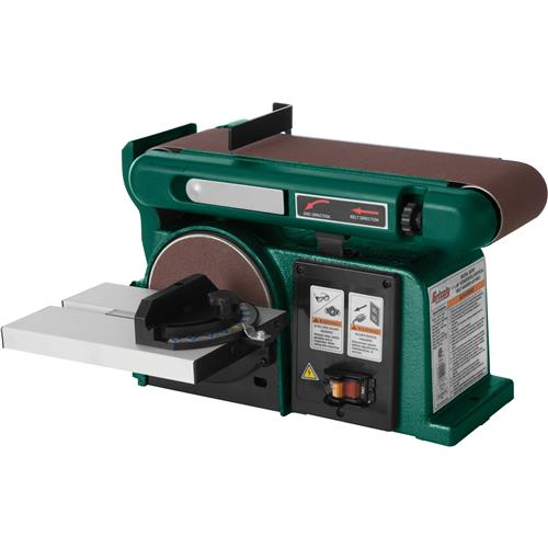

G0787 4" x 36" Horizontal/Vertical Belt Sander with 6" Disc
A great quality combination sander at a reasonable price.
The stationary G0787 4" x 36" Horizontal/Vertical Belt Sander with 6" Disc offers all the control and power you need for sanding smaller workpieces. Compact design is great for the smaller workshop.
The 4" x 36" sanding belt tilts from 0°–90°, allowing both vertical and horizontal belt sanding. A full range of replacement belts are available.
The back stop supports workpieces on the belt sander in any position.
The 6-1/4" W x 9" L work table supports workpieces when using the 6" sanding disc. It tilts from 0°–45°. Replacement PSA sanding discs are available in a variety of grits.
The belt tensioning lever provides tension to the sanding belt when pushed in and releases the tension when pulled out for changing belts.
A tracking control knob allows the user to adjust the alignment of the sanding belt to the sanding bed.
Additional features include a built-in an adjustable miter gauge, 2-1/2" dust port, and work table angle scale.
The G0787 manual was written by the U.S.-based Grizzly Technical Documentation Department and is packed with useful information. The complete and easy-to-read manual makes it easier to assemble and maintain your sander.
CSA certified
  • Motor: 1/2 HP, 120V, single-phase, 4.3A
  • Sanding belt size: 4" x 36"
  • Sanding belt speed: 1900 FPM
  • Belt platen size: 4-7/8" x 12"
  • Belt platen tilt 0–90°
  • Disc diameter: 6"
  • Disc backing type: PSA
  • Disc speed: 3600 RPM
  • Table size: 6-1/4" x 9"
  • Table tilt 0–45°
  • Number of dust ports: 1
  • Dust port sizes: 2-1/2"
  • Footprint: 6" x 15"
  • Overall dimensions: 17-1/2" W x 14-1/2" D x 24" H
  • Approximate shipping weight: 41 lbs.
  • Fast-tracking adjustment knob
  • Quick-release belt tension
  • Adjustable miter gauge
  • Cast-iron base
We offer U.S.-based customer service and technical support to get your questions answered and help keep your equipment running in top condition. And to ensure your satisfaction, the G0787 comes with a 1-year warranty.
