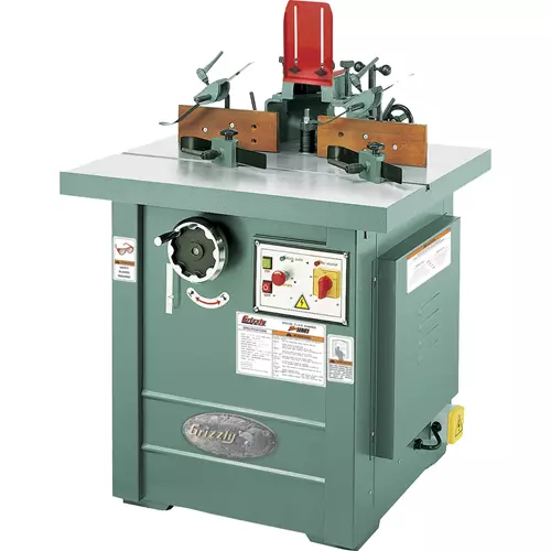

G5912Z 5 HP Industrial Spindle Shaper
Turn big shaper cutters with confidence.
The G5912Z 5 HP Industrial Spindle Shaper handles cutters up to 5-7/8" diameter by 5-1/8" tall. The four speed V-belt drive system lets you slow down those big cutters from 10,000 RPM to 3600 RPM.
A cutter guard is bolted to the precision-ground cast-iron table. A micro-adjustable wooden split fence lets you dial in for full edge cutting support. Four spring-steel hold downs increase safety and production by holding the workpiece flat on the table and snug against the fence.
The G5912Z comes with three interchangeable spindles 3/4", 1", and 1-1/4" plus three table inserts: 3" OD x 2" ID, 3-1/2" OD x 3" ID, and 7" OD x 3-1/2" ID.
The G5912Z manual was written by our U.S.-based Technical Documentation Department and is packed with useful information. The complete and easy-to-read manual makes it easier to assemble and maintain your shaper.
  • Motor: 5 HP, 220V, single-phase, 25A
  • Maximum cutter height: 5-1/8"
  • Maximum cutter diameter: 5-7/8"
  • Spindle diameters: 3/4", 1", 1-1/4"
  • Spindle lengths: 6"–7"
  • Spindle capacity under nut: 4-1/4", 4-5/8", 5-1/8"
  • Spindle speeds: 3600, 5100, 8000, 10,000 RPM
  • Spindle travel: 3-1/4"
  • Spindle openings: 2", 3", 3-1/2", 7"
  • Table counterbore: 7" dia. x 5/8" deep
  • Table size: 28" x 35-1/2"
  • Floor-to-table height: 34-3/4"
  • Footprint: 26" x 27"
  • Overall dimensions: 34-3/4" W x 35-1/2" D x 42" H
  • Approximate shipping weight: 604 lbs.
  • Cast-iron miter gauge adjusts 60° left/right
  • Spindle height scale in inches and millimeters
  • Two wood fence faces
  • Fence adjustment includes built-in ratchets and knob-equipped adjusters
  • Four spring-steel hold-down assemblies
  • Three interchangeable spindles 3/4", 1", and 1-1/4"
  • Three table inserts: 3" OD x 2" ID, 3-1/2" OD x 3" ID, 7" OD x 3-1/2" ID
  • Assorted wrenches included
