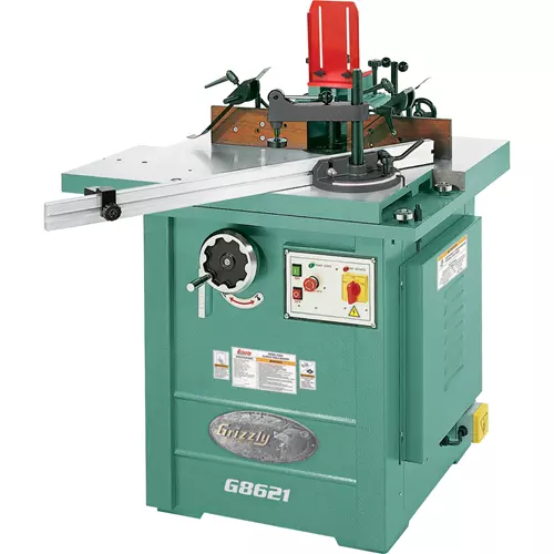

We’ve taken our immensely popular G5912Z shaper and made it even better with a sliding table! Extruded-aluminum sliding table fence and stock hold-down clamp integrated into the miter gauge make shaping ends and awkward-sized workpieces easier and more consistent.
- Motor: 5 HP, 220V, single-phase, 25A
- Sliding table size: 35-1/2" x 13-1/4"
- Sliding table travel: 21-7/8"
- Table size: 35-1/2" x 28"
- Table counterbore: 7" dia. x 5/8" D
- Floor-to-table height: 34-3/4"
- Spindle travel: 3-1/4"
- Spindle diameters: 3/4", 1", and 1-1/4"
- Spindle lengths: 6"–7"
- Spindle capacities: 4-1/4", 4-5/8", 5-1/8"
- Spindle speeds: 3600, 5100, 8000, 10,000 RPM
- Maximum cutter diameter: 5-7/8"
- Sliding table fence: 39-1/2" L x 4-1/4" H, extruded aluminum with adjustable stop
- Cast-iron miter gauge 0–60° left/right, with lever-actuated stock hold-down
- Footprint: 25-1/2" L x 26-3/4" W
- Approximate shipping weight: 757 lbs.
