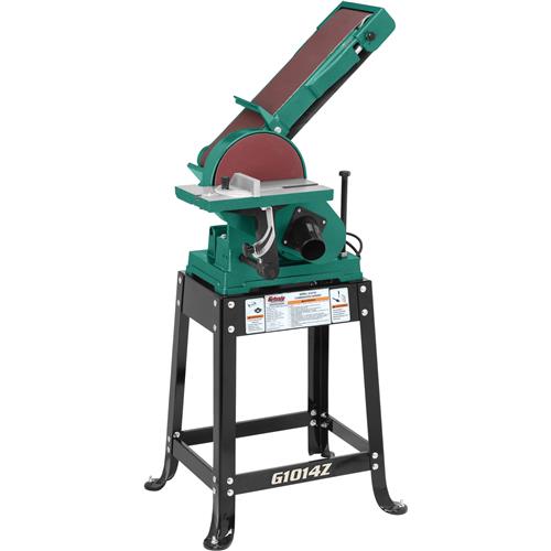

G1014Z 6" Belt / 9" Disc Combination Sander
Sized to fit the mid-to-large workshop and designed for accuracy and efficiency.
The G1014Z 6" x 48" Belt / 9" Disc Combination Sander can be used to smooth the faces, edges, or ends of workpieces using the sanding belt or the sanding disc.
The 6" x 48" sanding belt tilts 90° and can be used in both horizontal and vertical positions, or any angle between, based on your needs. A full range of replacement belts are available.
The 6" deep x 12-1/4" wide cast-iron work table supports workpieces when using the 9" sanding disc or the belt when it is in the vertical position. The back stop supports workpieces on the belt sander in any position.
The work table tilts from 0° left to 45° right and the miter gauge can be adjusted 60° left to 60° right for the desired angle.
Replacement PSA sanding discs are available in a variety of grits.
The G1014Z offers a quick release system for lightning-fast belt changes and a convenient, single-knob tracking control system.
The G1014Z features a rock-solid A-frame stand to minimize vibration.
The G1014Z manual was written by our U.S.-based Technical Documentation Department and is packed with useful information. The complete and easy-to-read manual provides full instructions on how to assemble and maintain your sander.
  • Motor: 3/4 HP, 110V/220V (prewired for 110V), single-phase, 12A/6A
  • Sanding belt size: 6" x 48"
  • Sanding belt speed: 1900 FPM
  • Platen size: 6-1/4" x 17"
  • Belt sanding head tilt: 0°–90°
  • Sanding disc diameter: 9"
  • Sanding disc speed: 2420 RPM
  • Sanding disc type: PSA
  • Disc sanding table size: 12-1/4" W x 6" D
  • Disc sanding table tilt: 0°–45°
  • Number of dust ports: 2
  • Dust port sizes: 2" and 2-1/2"
  • Footprint: 23" x 19"
  • Overall size: 30" W x 24" D x 56" H
  • Approximate shipping weight: 137 lbs.
  • A-frame stand to minimize vibration
  • Quick-release belt mechanism
  • Cast-iron table, disc, and body
  • Graphite-coated platen
  • 1-year limited warranty
