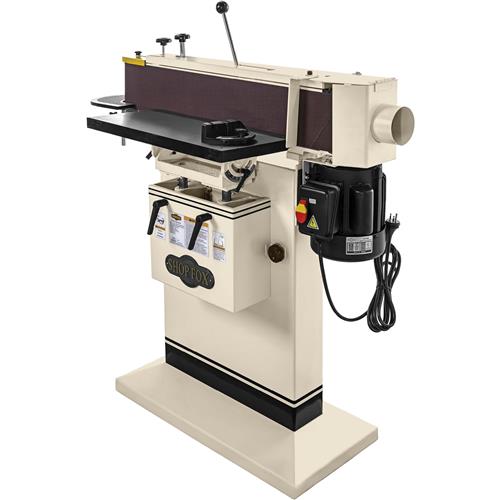

Shop Fox W1688 6" x 80" Edge Sander
Industrial-like quality and compact size that won’t hog precious shop space.
The W1688 6" x 80" Edge Sander features a graphite-coated cast-iron platen and precision-ground cast-iron tables.
The 3-3/8" diameter rubber roller allows you to get into tighter radius projects such as curved chair legs, guitar bodies, etc.
Equally important, the quick-release belt tension lever makes changing belts a breeze and all controls are thoughtfully placed for convenient access.
A full range of replacement belts are available.
The W1688 manual was written by our U.S.-based Technical Documentation Department and is packed with useful information. The complete and easy-to-read manual provides full instructions on how to assemble and maintain your sander.
  • Motor: 1-1/2 HP, 110V/220V, prewired 220V, single-phase, 16A/8A
  • Sanding belt size: 6" x 80"
  • Sanding belt speed: 1800 FPM
  • Belt sanding head tilt: 0–90°
  • Table size: 10-1/2" x 22"
  • Table travel: 5"
  • Platen: 6-3/4" x 29-3/4", graphite-coated
  • Idler roller: 3-3/8", Rubber
  • Drive roller: 4-1/4", Aluminum
  • Footprint: 14-1/2" W x 29-1/2" L
  • Overall size: 47" W x 20" D x 49" H
  • Approximate shipping weight: 311 lbs.
  • Two-year warranty!!
  • Sanding surface tilts vertical to horizontal
  • Belt tracking and tension adjustment
  • Quick belt release
  • Spring-loaded table elevation
  • Shielded and lubricated ball bearings
  • Built-in dust hood with 4" dust port
  • Miter block
Please note: To accommodate the machine's footprint, extension bars may be necessary when using a mobile base.
