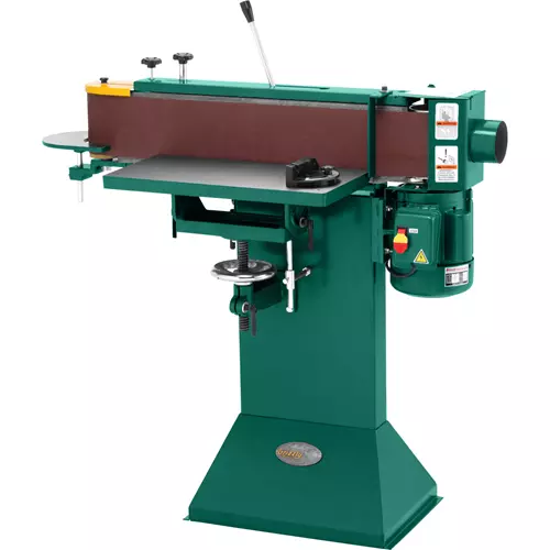

Grizzly G1140 - 6" x 80" Floor Model Edge Sander
4.8 (31)
$1,195.00
G1140 6" x 80" Floor Model Edge Sander
Effortless edge sanding for doors and long stock.
Sanding long edges and door panels can be a hassle. The G1140 Floor Model Edge Sander tackles this challenge with nearly 30 inches of vertical sanding surface, eliminating the need for multiple passes.
The height-adjustable contoured support table lets you sand curved panels with ease, while the 6" x 80" belt ensures even sanding across wide surfaces.
Tight radius sanding is a breeze thanks to the 3-3/8" end roller. Plus, conveniently located lock knobs make belt tracking and tension adjustments simple.
Spend less time fiddling and more time sanding with features like quick belt release and a built-in dust hood that minimizes cleanup.
For a full range of replacement belts for the G1140, shop here.
The G1140 manual was written by our U.S.-based Technical Documentation Department and is packed with useful information. The complete-and-easy to read manual makes it easier to assemble and maintain your sander.
  • Motor: 1-1/2 HP, 110V/220V (prewired 220V), single-phase, 20A/10A
  • 22" x 10-1/2" cast-iron table with miter block
  • Amps: 20A at 110V, 10A at 220V
  • Sanding belt speed: 1800 FPM
  • Sanding belt size: 6" x 80"
  • Sanding belt tilt: 90°
  • Table tilt -60°–+60°
  • Table travel: 6"
  • Floor to table height: 35"
  • End table: 4-1/4" x 8", adjustable vertically 3-1/2"
  • Platen: 6-3/4" x 29-3/4"
  • Dust port: 4"
  • Footprint: 21-1/2" x 15"
  • Overall dimensions: 47" W x 20" D x 49" H
  • Approximate shipping weight: 269 lbs.
  • Sanding surface tilts vertical to horizontal
  • Graphite-coated platen
  • Quick-release belt lever
  • Conveniently located belt tracking and tension adjustment
  • Handwheel table height adjustment
  • Paddle switch with safety key
  • Built-in dust hood
