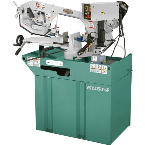

G0614 6" x 9-1/2" 1-1/2 HP Swivel Metal-Cutting Bandsaw
Need more capacity in a swiveling metal-cutting bandsaw?
Check out the range of cuts you can get with the 0° to 60° locking turret of the well-engineered G0614 6" x 9-1/2" 1-1/2 HP Swivel Metal-Cutting Bandsaw.
Lever controlled blade guide locks allow adjustments right up to the work piece for optimum support and the blade guides have fully adjustable ball bearings so you know you're going to get straight cuts.
The two-speed, 1-1/2 HP motor can change speeds from 1725 to 3450 RPM, giving the 97-5/8" x 1" blade two cutting speeds of 170 and 341 feet per minute.
The quick-release vise and stock length stop allow for a quick transition to get on with the next cut.
The splash tray reduces cutting fluid loss at the end of a workpiece when cutting at 60°.
Additional features that allow you to get the most saw for your money include the infinitely adjustable hydraulic down feed and the coolant system.
