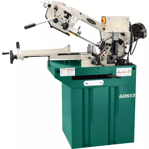

G0613 7" x 8-1/4" 1 HP Swivel Metal-Cutting Bandsaw
This metal-cutting saw is built for accuracy and production!
With the G0613 7" x 8-1/4" 1 HP Swivel Metal-Cutting Bandsaw, easy angle set-ups between 0° and 60° means no wasted time between cuts.
Lever controlled blade guide locks allow adjustments right up to the work piece for optimum support and the blade guides have fully adjustable ball bearings so you know you're going to get straight cuts.
The 82" x 3/4" blade rotates at 314 FPM while the adjustable hydraulic downfeed allows maximizing the blade life. The cutting fluid system gives the saw a wider cutting range than a single speed bandsaw that is not equipped with a cutting fluid system.
The splash tray reduces cutting fluid loss at the end of a workpiece when cutting at 60°.
The quick-release lever and stock length stop allow for a quick transition to get on with the next cut.

  • Motor: 1 HP, 110V/220V (prewired for 110V), single-phase, 16.8A/8.15A
  • Pump motor: 1/8 HP, 0.9A/0.45A
  • Blade size: 82" x 3/4"
  • Blade speed: 314 FPM
  • Cutting capacities:
    • 90° Round: 7"
    • 90° Rectangular: 7" x 8-1/2"
    • 45° Round: 4-1/4"
    • 45° Rectangular: 4" x 4-1/4"
    • 60° Round: 2"
    • 60° Rectangular: 2-3/4" x 2"
  • Miter cutting capacity: 0°–60°
  • Floor to table height: 35-5/8"
  • Footprint: 26-1/4" x 22"
  • Overall dimensions: 63" W x 29-3/4" D x 66" H
  • Approximate shipping weight: 460 lbs.
  • Swivel mast with degree scale
  • Centralized control panel
  • Heavy-duty all steel, one piece base
  • Adjustable hydraulic downfeed
  • Deep throated vise with lever lock
  • Quick-release vise
  • 0° to 90° Swivel
  • Tooth selection chart
  • Built-in coolant system
  • Automatic shut-off
  • Adjustable ball bearing blade guide system
  • Blade wheels have heavy-duty ball bearings
